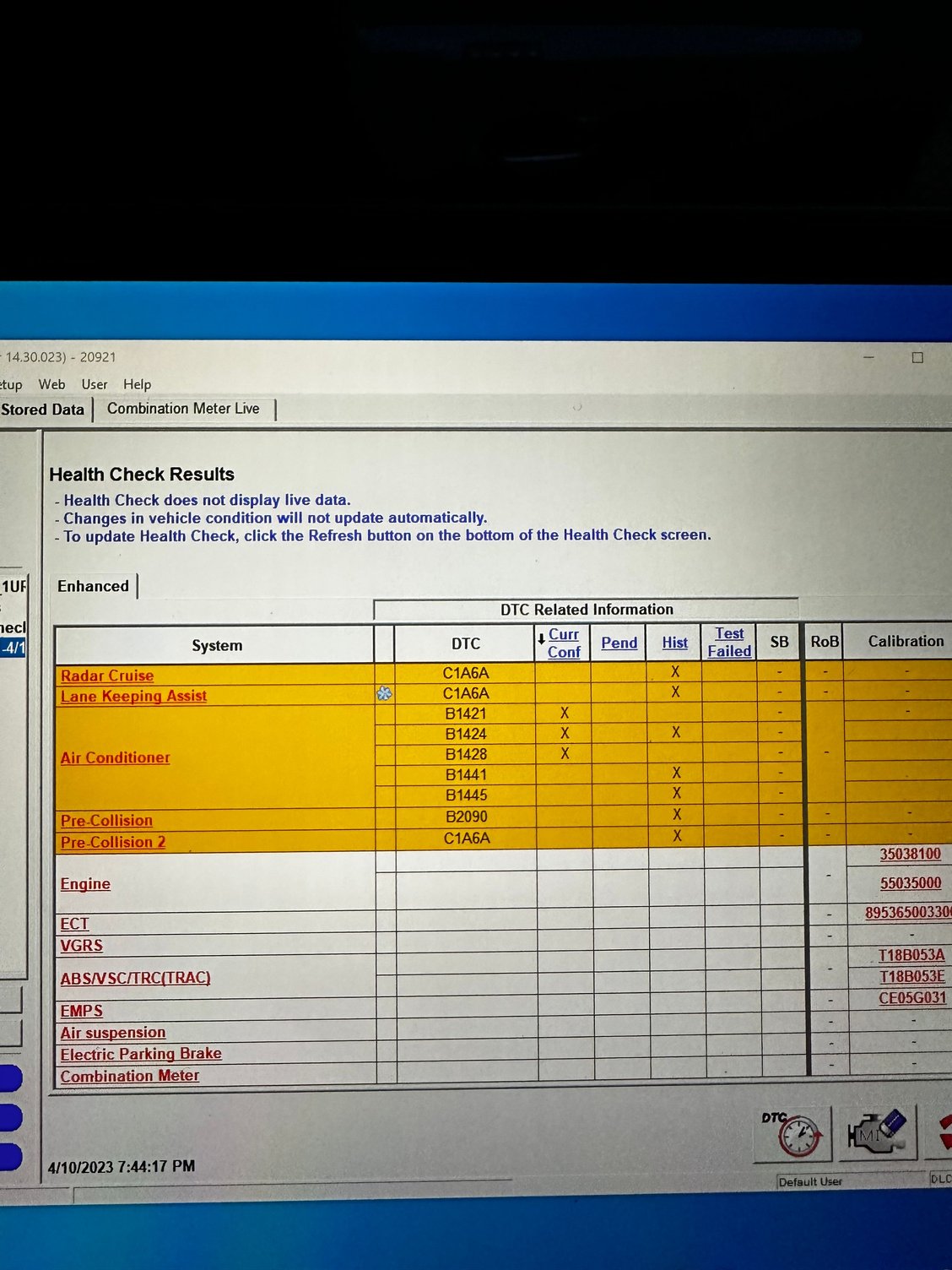

Before spring I had read my codes and I did have several A/C codes . Here is a picture.
Today , I just scanned for codes again. And had no A/C codes . 🤷
I believe some were for the solar sensor, which was blocked by my dash mat. Which makes sense why they aren’t there anymore as I’ve removed the dash mat and resealed the dash.
p.s PCS, LKA, and RC are related to the bumper swap .
