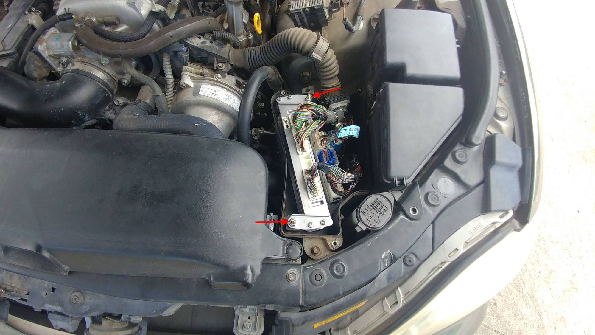

Adding some pictures in case someone else comes across this thread.
I labeled the area that houses the ECU. You need to remove the cover above the ECU compartment by removing the plastic push pins with a plastic interior tool. You will need to remove the upper cover in order to get to the three screws that hold the cover on the ECU cover. Once the ECU cover is removed you just have to unplug the ECU and remove the two nuts holding it place. Both the screws and nuts are 10mm.
