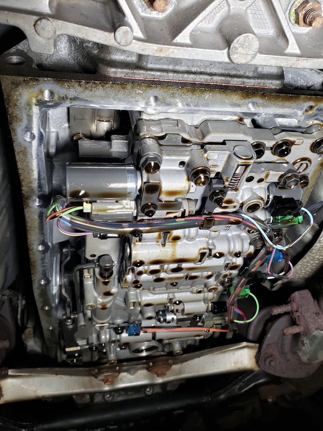

307k miles on my 2004. Former owner followed the Lexus recommendations, which means tranny fluid was never touched. Most of those miles were highway. He also towed an ATV occasionally for a couple of years. Not great I know. I knew I would be playing with fire by touching the transmission but after extensive reading I decided to do a pan drop and refill (approx. 4 qts) with filter screen change. The thinking is that if there is a failure soon after, the tranny was on it's way out anyway and the service just exposed it quicker. I dropped the pan and followed the factory refill procedure with the car level and the tranny temp just right when removing the overflow bolt.

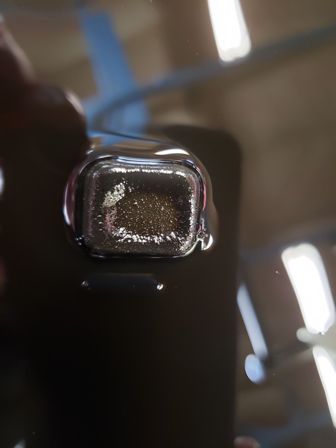

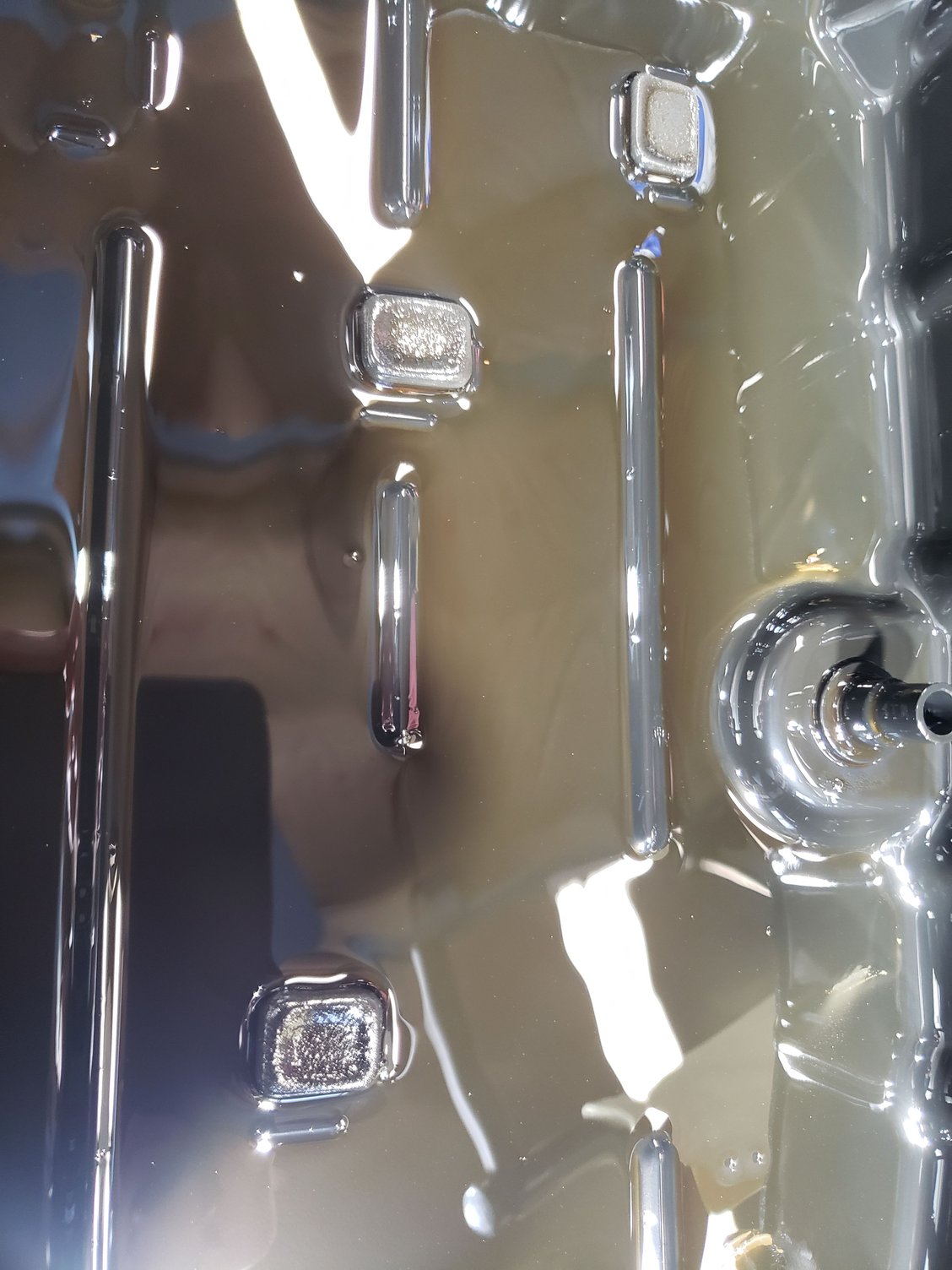

There were a few small bits of metal but not much in the way of shavings on the magnets. The fluid was very dark, almost black, but no burnt smell at all. I installed a new OEM screen/filter, filter o-ring and gasket, but my one variable which I wish I hadn't done is refill with 4 qts of Valvoline Maxlife ATF. That debate is for a whole different thread, but I have not found a single report of failure due to using the Maxlife. However, I wonder with my high miles if the different composition of the fluid and maybe stronger detergents contributed to my problem. Within a week of the change and a hundred miles later, the torque converter began to shudder when lightly accelerating in all gears. I can use the manual shift without shudder. No problems with moderate or heavy acceleration. I did another fluid change and added back 4 qts of Toyota WS but I know there is still some Maxlife mixed in there. I also dropped the pan again to check that the o-ring on the filter was seated properly which it was. I'm not disappointed that the A761E tranny would be failing at over 300k, but I wonder how long it may have gone if I left it alone. From more research, I think the best guess is that the detergents in the new fluid loosened some debris which is stuck somewhere in the valve body. One shop wanted to drop the whole tranny to investigate, another wants to remove and clean the valve body, and a third says to keep driving to see if the debris gets dislodged (if in fact that is the problem).
