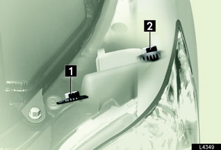

Adjusting the vertical aiming
1. Adjusting bolt A
2. Adjusting bolt B

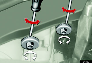

1. Turn bolt A in either direction using a Phillips-head screwdriver.
Remember the turning direction and the number of turns in mind.
2. Turn bolt B the same number of turns and in the same direction as step 1 using a Phillips-head screwdriver.
After adjusting the headlight in the vertical direction, check if the light has been shifted from the adjusted position in the horizontal direction.

Please notice that, in this application, turning your Phillips-head screwdriver clockwise causes the mechanism to move counterclockwise and vice-versa. No worries, as you will soon find which way raises or lowers by observing the light's movement as you turn....
