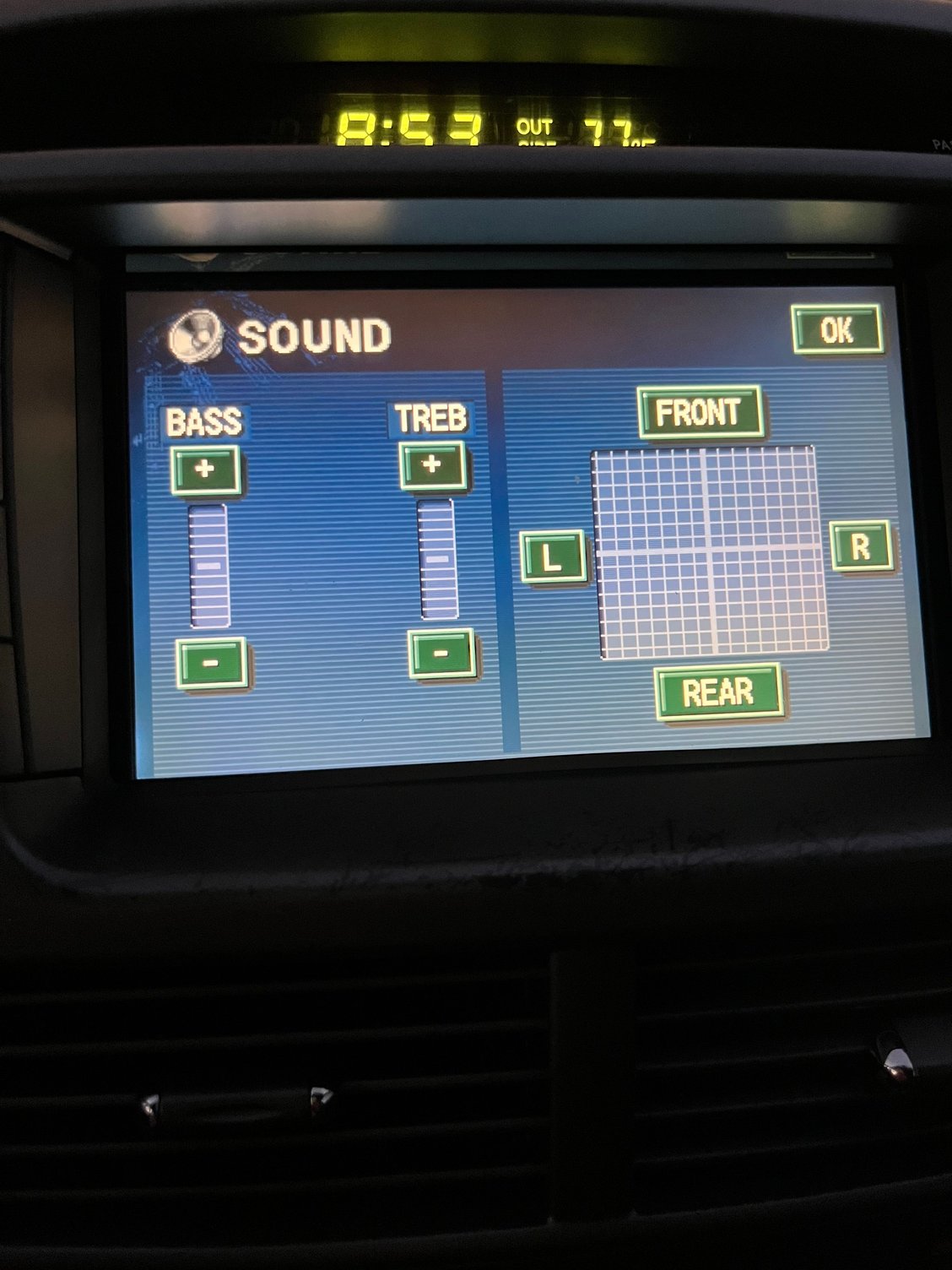

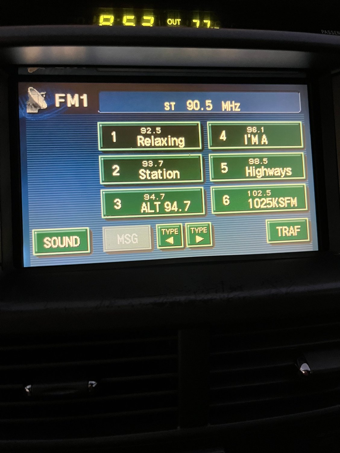

Hey guys, I have an 04 with ML audio. I can turn ON the radio by pushing down on the volume button but I have no sound or Sound options. I can’t hear anything or increase the volume. Right before this happened I heard a loud Crackle sound.
The Sound options are gone. I can’t adjust the sound or fader.
No Sound options?

Chances are the ML amp (in the trunk) has died.
I believe there is somewhere you can send them to get them repaired.
Hopefully someone will chip in with who.
Otherwise, it may be worth finding a used ML amp on eBay.
