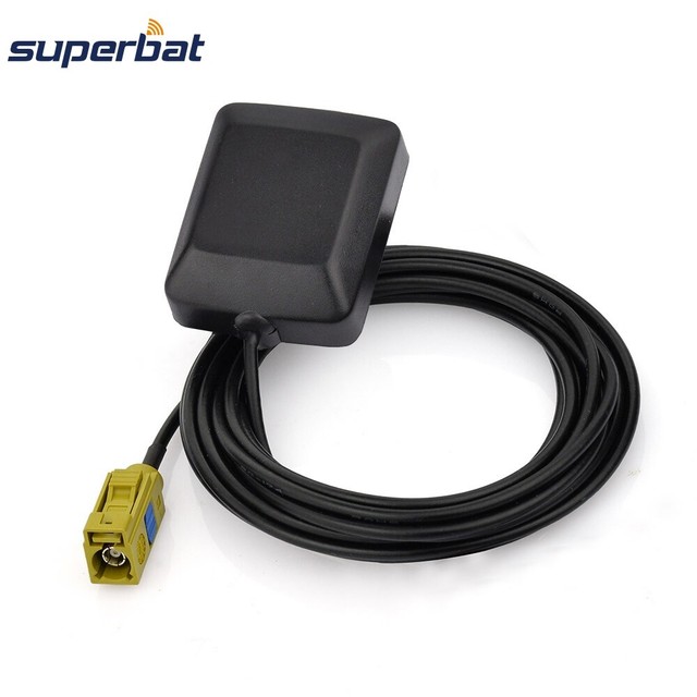

Do you get the SiriusXM preview channel 001? If yes you are set up. The antenna is small almost square often located near the rear window next to the Center High Mount Stop Lamp (CHMSL) and sometimes on the deck lid. (The antenna on the roof is for Lexus Link and anymore does basically nothing.)
The antenna looks something like the one below ...
