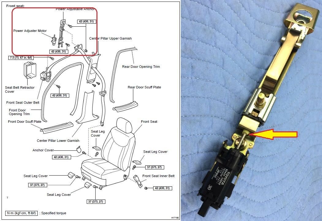

Been looking around for a fix with no success...left side seat belt height adjuster not working but I hear the motor working. Anyone deal with this?

Most likely the motor's drive shaft is detached from the anchor slider screw or the connection is stripped. Take a look at the sketch below for detail on how you access the motor to inspect.

Much thanks to you!
