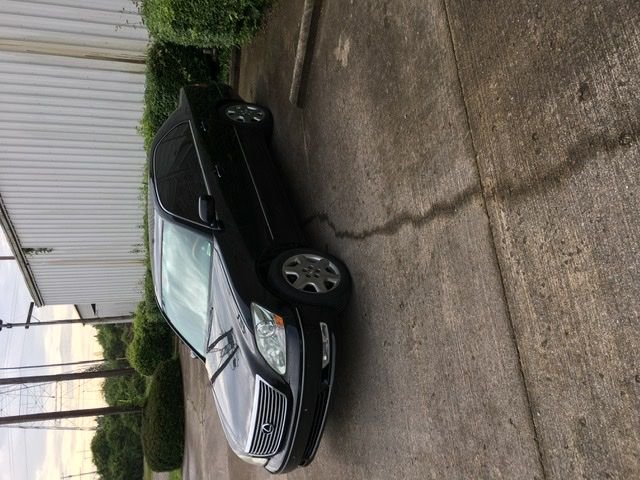

Well I got the front upper control arms and Monroe quick struts put in. I now have massive wheel gap but the front end doesn’t dive and it rides better. Hopefully they settle, or I need to do rears but they don’t make a quick strut for the rear. Fronts that came off were kyb and maybe original but not sure. Took about 45 a side start to finish.

Question. At what position of suspension have you torqued the bolts of upper control arm and strut bushings?
