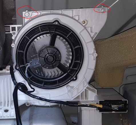

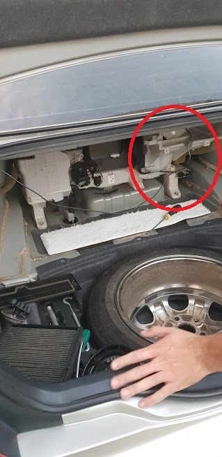

Yes.. I had it out with a help of a friend, not gonna lie, it was a pain!
the only way to reach it is through the trunk, remove the trunk covers carefully as they can easily bend and the whole assembly will be exposed. you need to remove the highlighted plastic cover. it's installed by 4 nuts.. 3 of them are easily reachable, the forth one is hidden from the inside so you need to blindly feel it.
below are two pics I took back then on that day.. sorry if the quality is not the best. hope it helps!

Awesome thanks for the quick response and the pictures help a lot! I was already in there to replace my ML Amplifier so I thought I could knock this out at the same time.
I see you also found the nice surprise that the subwoofer speaker rubber rotted away. That's my next task after the A/C blower motor.

I may have done it differently but I figured out what the hang up was there are two plastic retainers that need to be released prior to getting the whole thing out.
