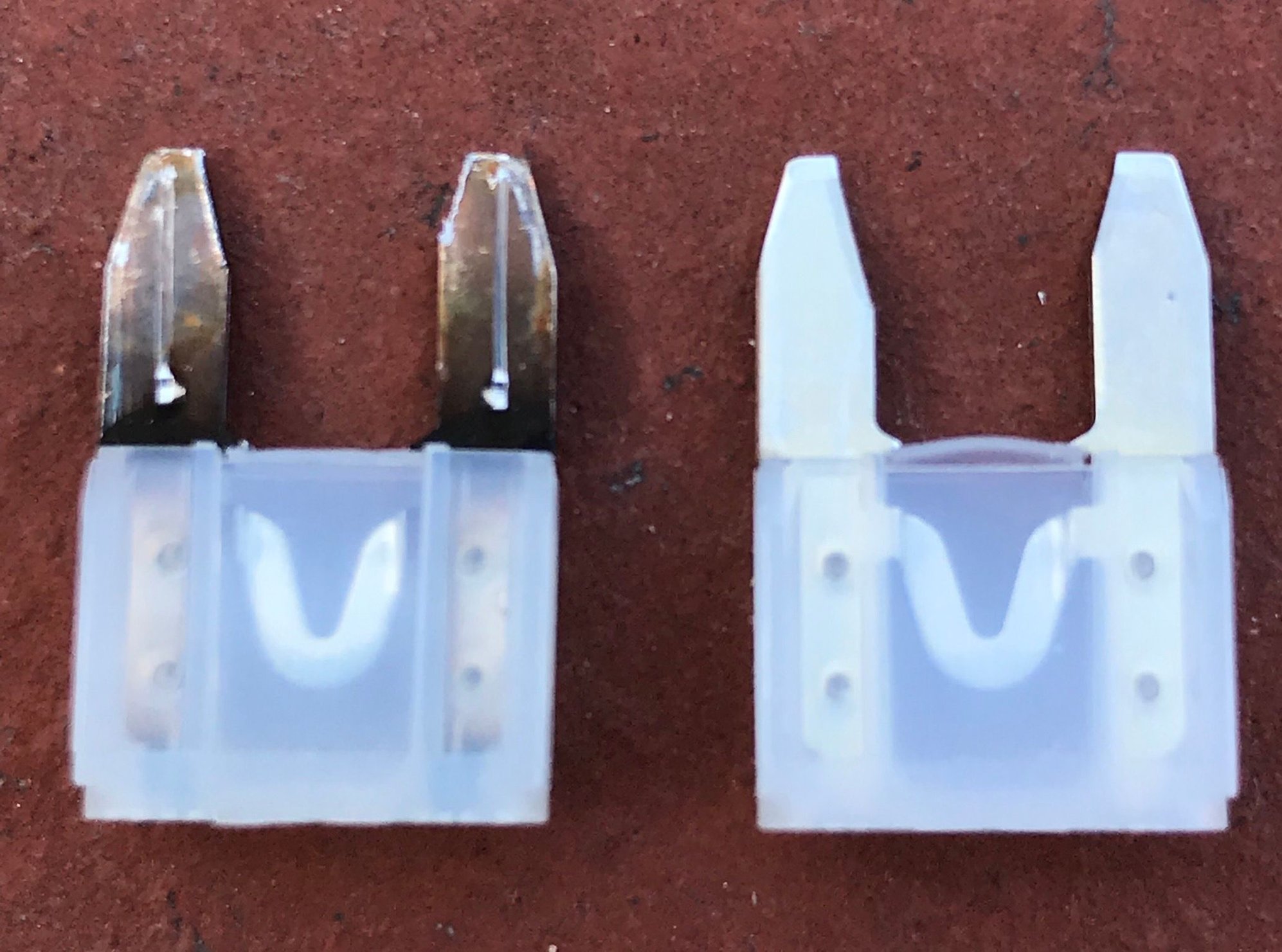

Hi all. The front passenger power door lock and power window of my 2004 LS430 stopped responding to all the power switches and remote key fob. I can still manually lock the door. The remaining three doors still work fine. I replaced fuse #35 of the passenger side kick panel but this did not fix the issue.
Any thoughts on what to look into next? Thanks for your help.
Old fuse on the left.

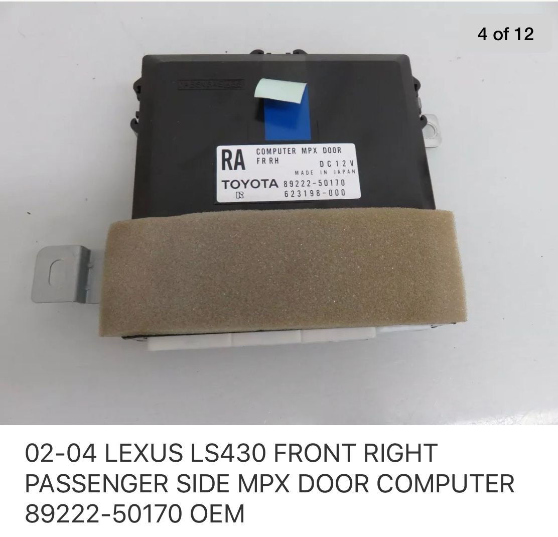

I worry that the wiring harness to the door is stressed and one or more wires are open inside or the MPX door computer is not working well.

Hello, i had the same problem. Turns out there is a computer in the each door that works locks,windows, mirrors. Take a look. I bought a replacement on ebay.
Hi @kelleher2
Could you please share the eBay link or the part number you bought to fix this problem? Thanks

I found this part on eBay. I guess this is what I need. I wonder if anyone has experience replacing this and can comment on the level of effort?
