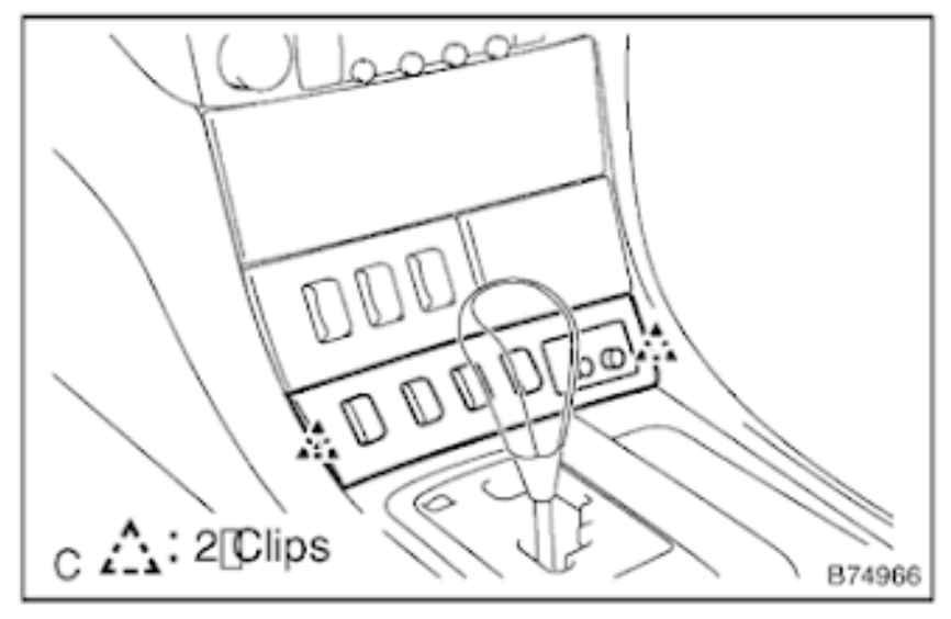

I used this pry tool to pry the controls where the seat climate controls are. (Either will work) But you can also use a metal tool with tape at the end that is slightly smaller.
This shows where the clips are located. I was being very gentle at first trying not to break anything but soon realized that these clips are VERY DURABLE and I had to use some force. It takes some time getting used to pry out the trim, you just have to experiment and work at it. When it does come out I tried to remove the wire plug but it was super stiff and I didn't want to break anything so I left it in.
Credit goes to GROM.
