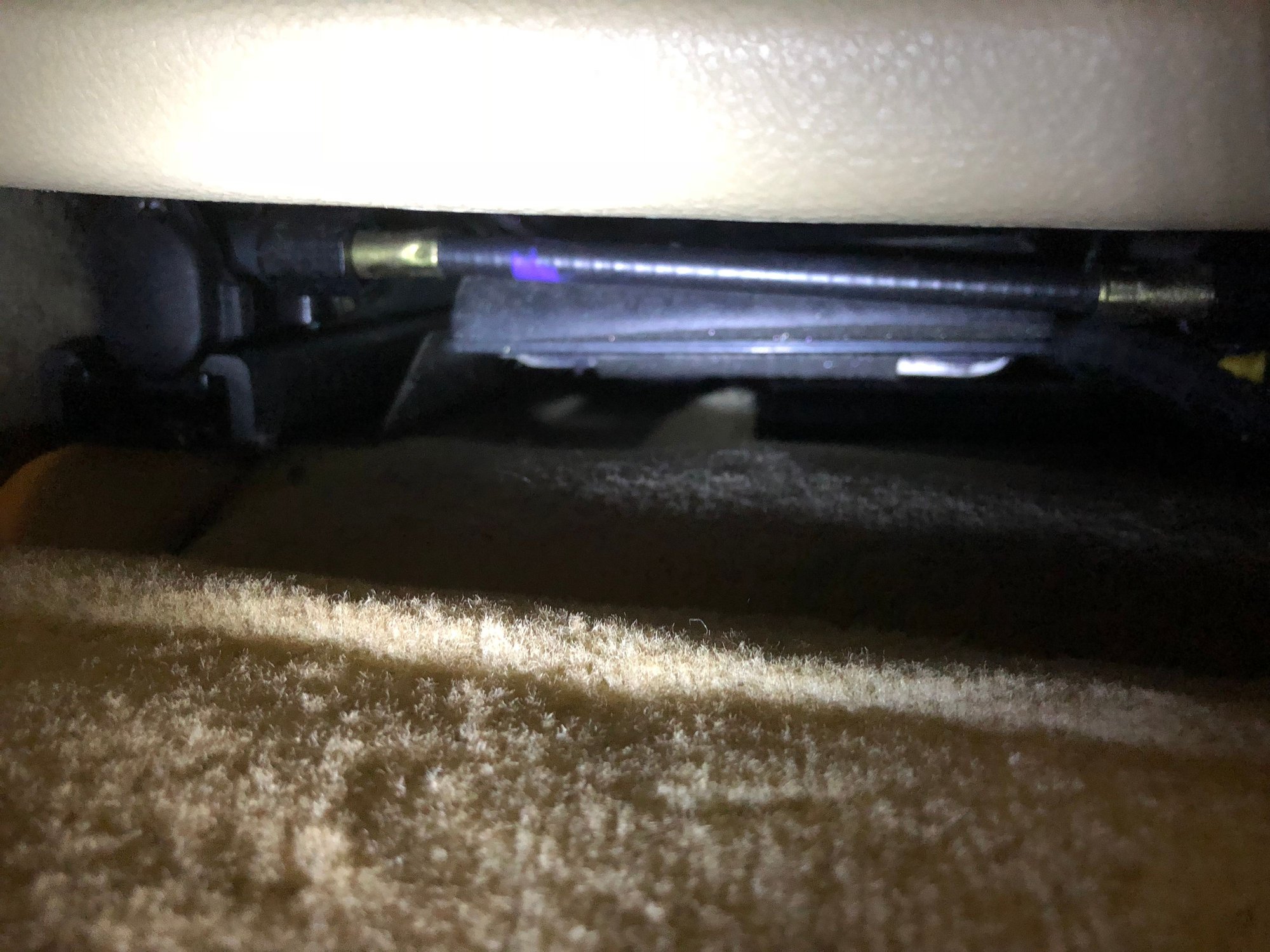

Welcome to the site and sorry to hear your seat fan is noisy. Much more knowledgeable people than I can comment but I would start with two items. 1) Use a shop vacuum on the leather seat to clean any debris which may have found its way into the perforations in the leather. 2) Raise your seat(s) fully up, fully back and reclined so you have maximum room to see the seat filter. Inspect it for dirt & dust. You may be able to vacuum the filter or a forum member can tell you how to remove the filter. 3) If the filter is removed I wonder if dirt on the fan itself has caused an imbalance therefore creating noise.
Heres a picture of the drivers side front filter ( that rectangular piece).
