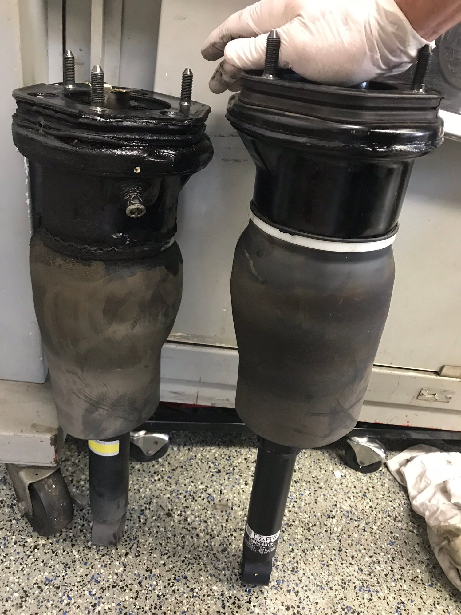

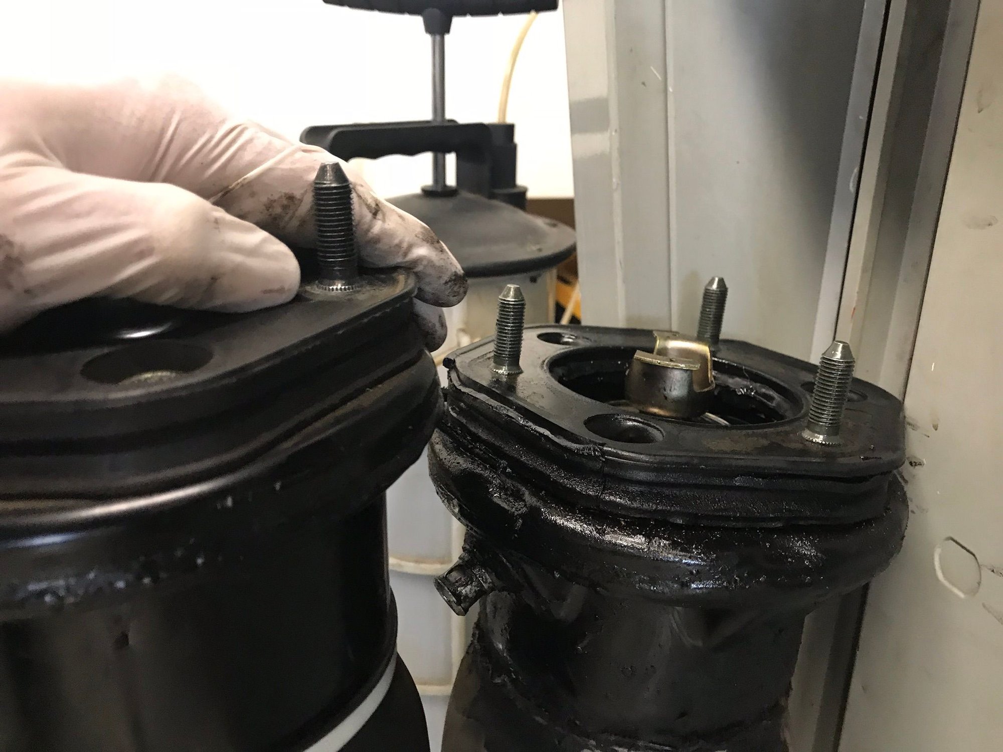

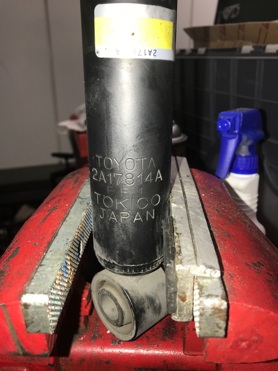

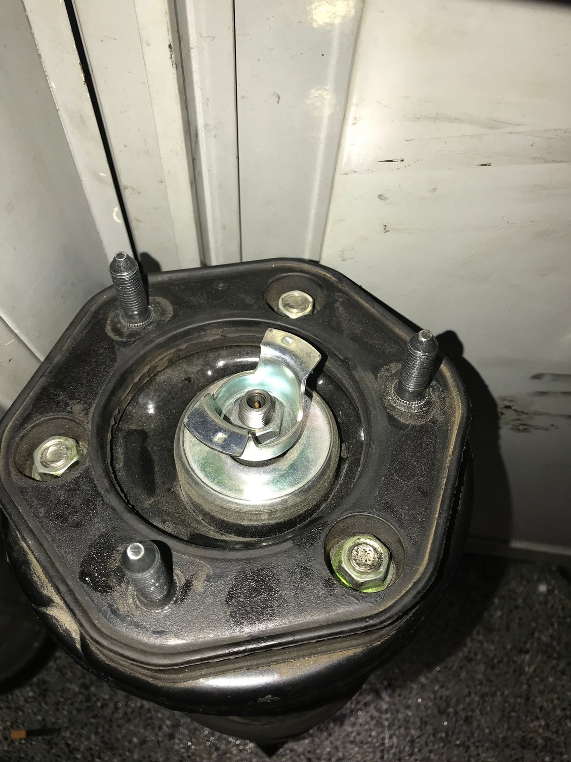

MYSTERY SOLVED!
I removed my defective strut today and discovered the difference. The 2001-2003 struts are manufactured by a Tokico and the 2004-2006 are manufactured by KYB. Outer dimensions as far as fitment to the vehicle are the same. The top part of the strut looks identical. The lower tube of the Tokico strut is slightly larger and feels just a tad bit heavier. Pictures soon to follow.
KYB STRUT 04-06
KYB STRUT 04-06
Tokico strut 01-03
KYB STRUT 04-06
KYB STRUT 04-06
Tokico strut 01-03

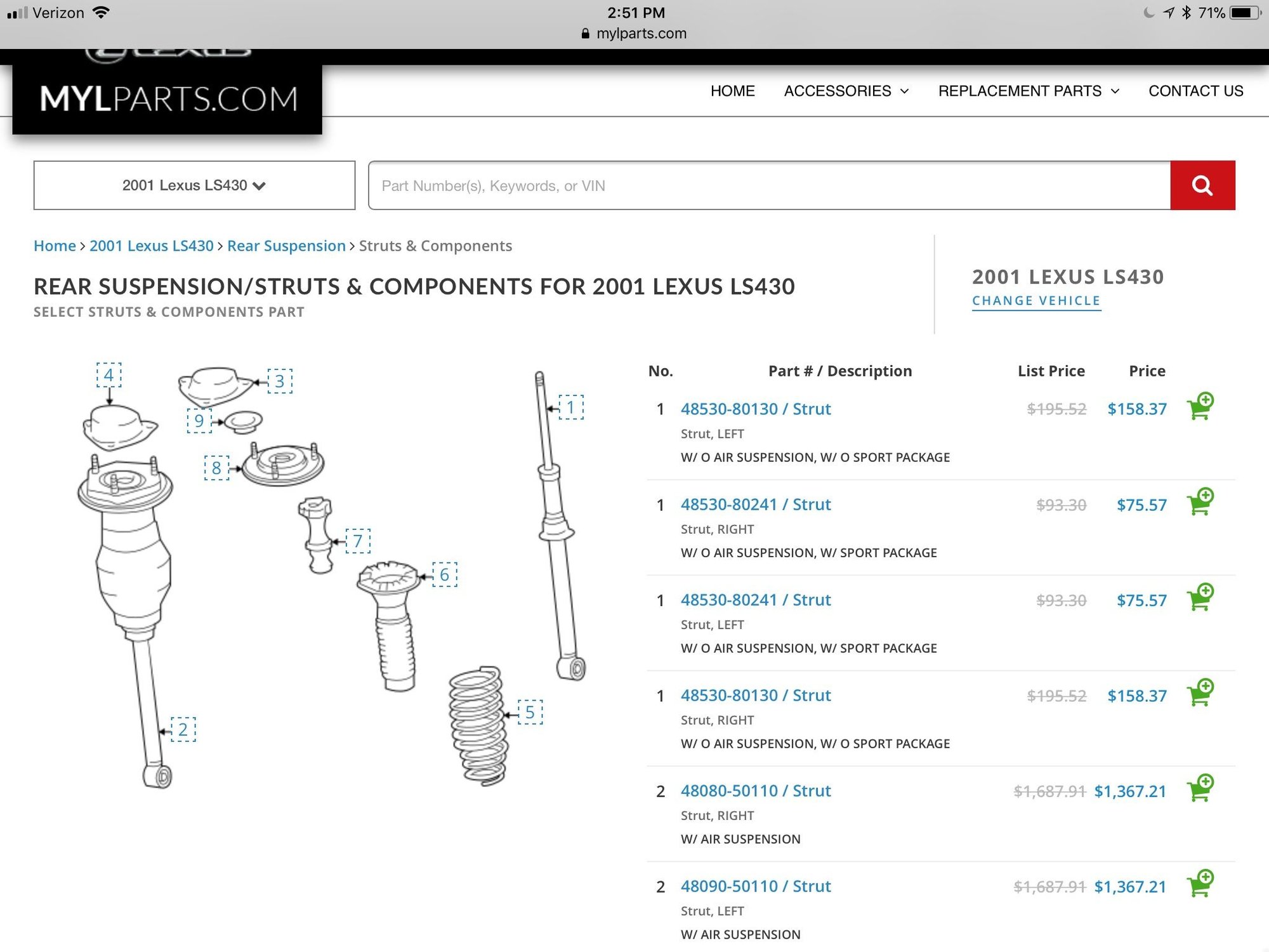

(UPDATE)
I just checked the part number of the strut "48080-50110" and looked it up MYLPARTS.COM and the left and right side are the same!

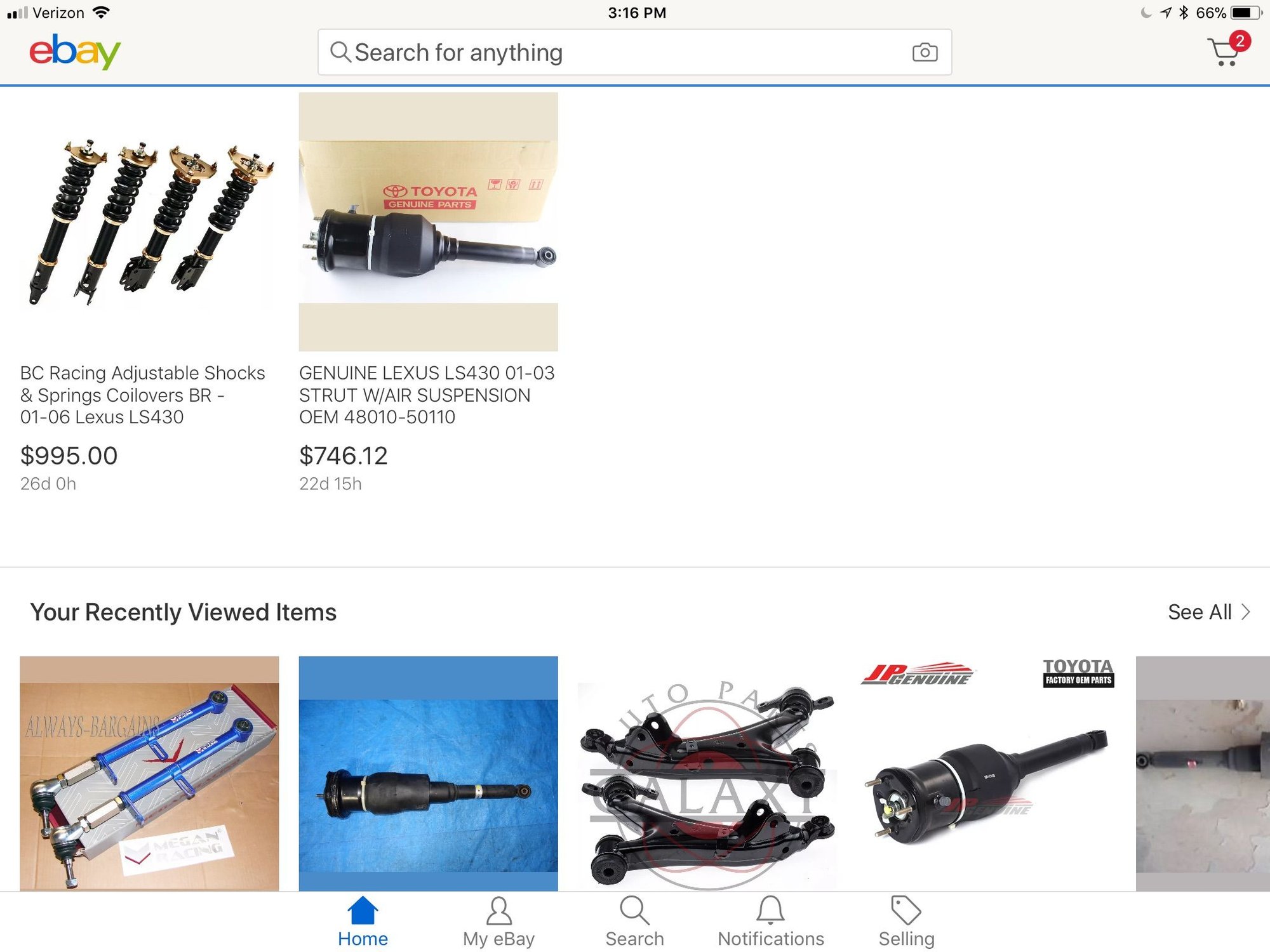

The least expensive place to purchase this is on eBay for around $750 per side with free shipping as they are much more expensive at MYLAPARTS.COM .
I found more of a selection on eBay when I searched by "LS430 REAR AIR STRUT" than I did by the part number.

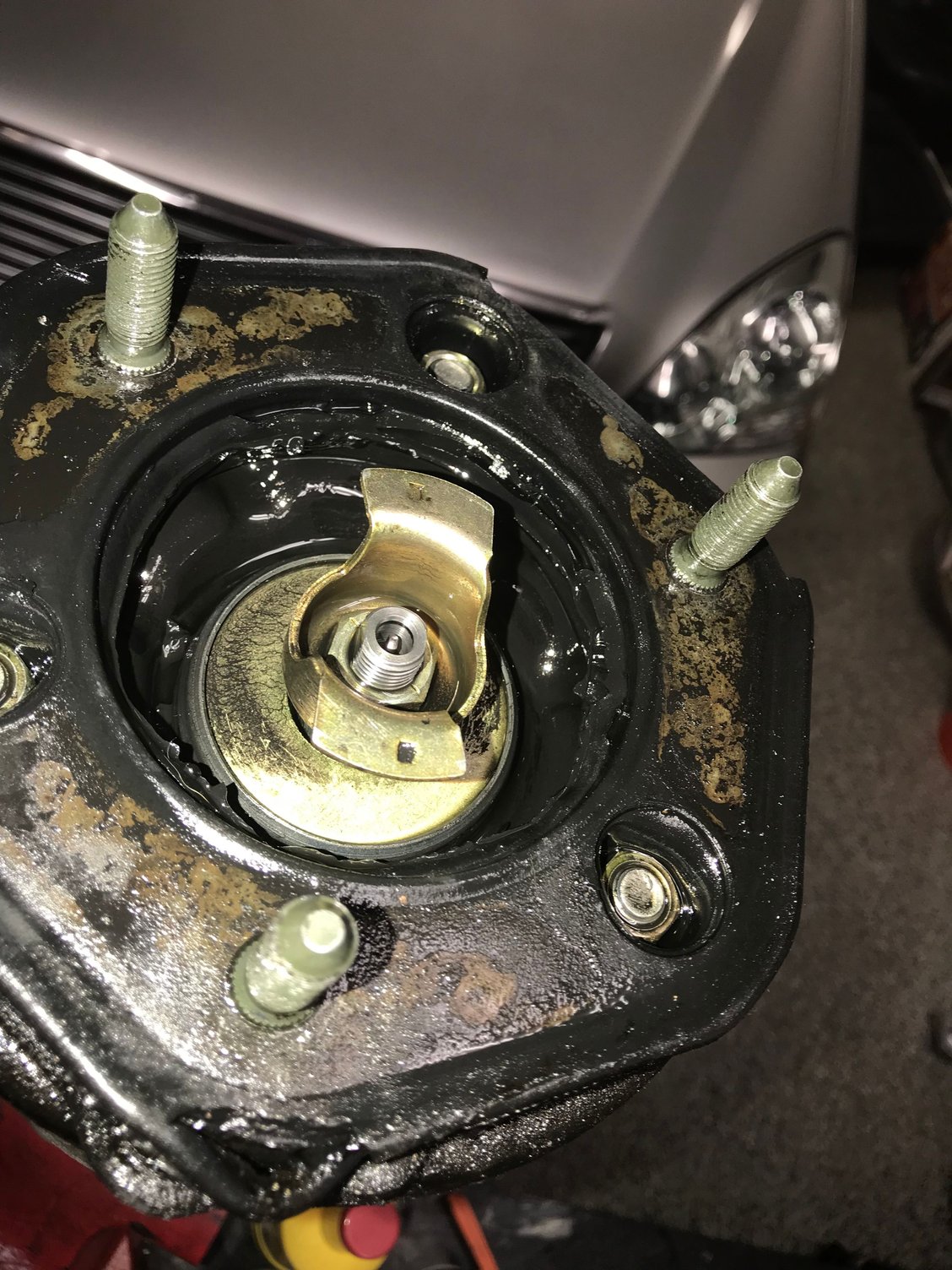

I almost bought one because I found a little bit of oil on the top of the strut on the left side but I decided not to replace it at this time since it still drives fine and it was only very little oil. My car rides very nice now!

I also found that the Tokico rear struts are about 1” shorter than the later KYB struts. This was probably because 2004-2006 LS430’s featured the 18” wheels.
Extended
Fully compressed

Originally Posted by Vmost66
MYSTERY SOLVED!
KYB STRUT 04-06
KYB STRUT 04-06
Tokico strut 01-03
KYB STRUT 04-06
KYB STRUT 04-06
Tokico strut 01-03
Unfortunately, this is invalid at the present time. OEM struts installed at the factory and OEM struts sold in the market are two different products.
I have 01-03 softer struts on my 06 Lexus and they are made by KYB. Very very high quality product, especially if put on new OEM rubber strut mounts.
