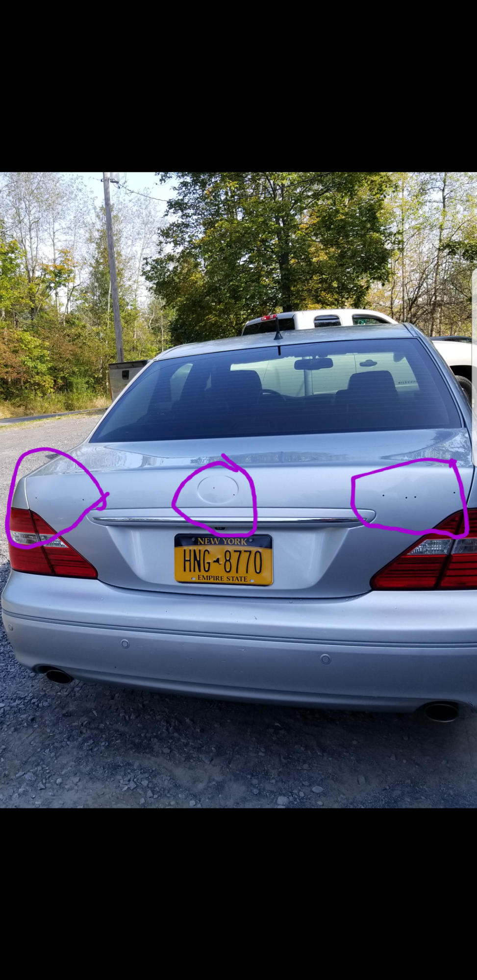

Use a plastic spackle knife or interior trim removal tools, to remove the emblems.
There are pins behind them so you either need to get the holes welded shut or put rubber plugs in them.
What your trunk will look like with emblems removed
Circled in purple are the holes left after removing emblems.
