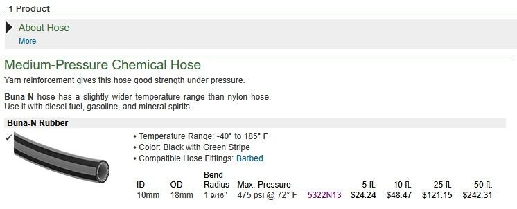

When I had the LS400...
This is the only 10mm hose that I could find that's compatible with ATF. Yes, the color is odd, but it's not readily seen when you open the hood.

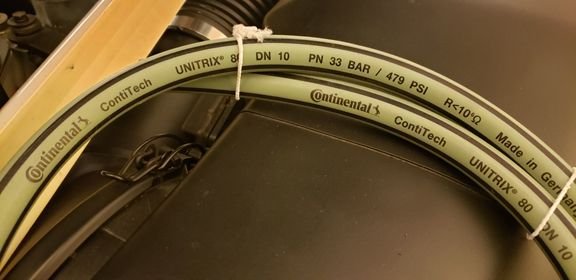

https://www.clublexus.com/forums/ls-...l#post11472247
https://www.mcmaster.com/
This is nice. Made in Germany hose. Rather have this than chinese knockoffs. BOught one. Which clamps did u use? OEM? any fitting issues with clamps?
