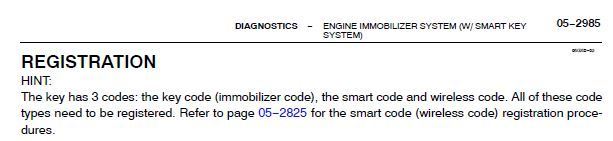

According to the technical manual, the FOB holds 3 security codes, as described below
The "immobilizer code" allows you to unlock the steering column and turn the ignition.
The "smart code" let the car knows that you're nearby which will do things like turn on the puddle light and allow you to touch the inside of the door handle to unlock the door. Does your FOB do these functions?
The "wireless code" allows the remote push buttons to operate (door, trunk, panic button, etc.)
I think we can say that you installed the battery correctly, although it may be too weak to fully power the FOB.

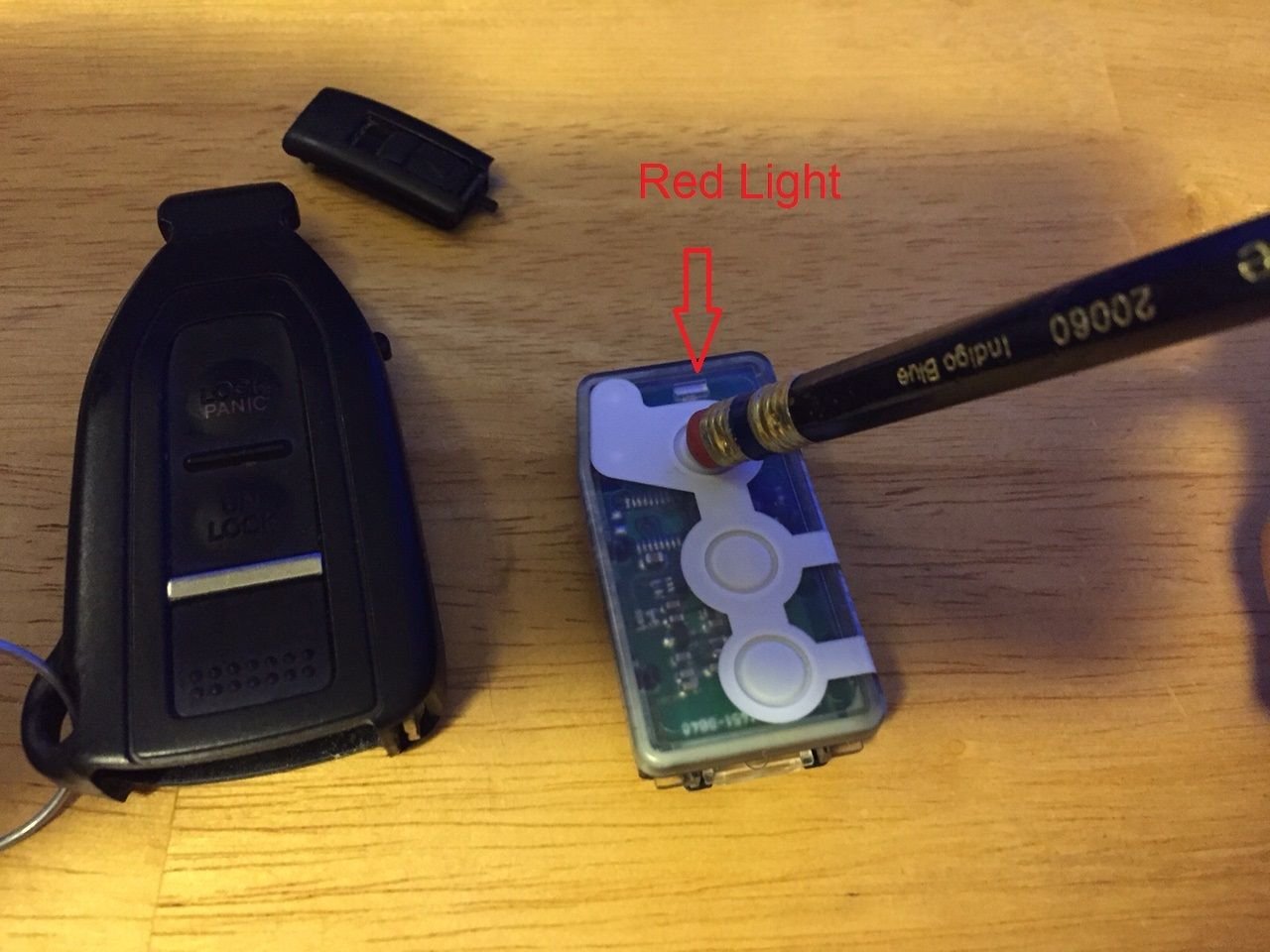

No red light when you push a button on the FOB is troublesome. Please try to remove the FOB cartridge from the casing and push the buttons directly to see if you see a flash of red light. You may have a defective FOB casing. See photo below:
