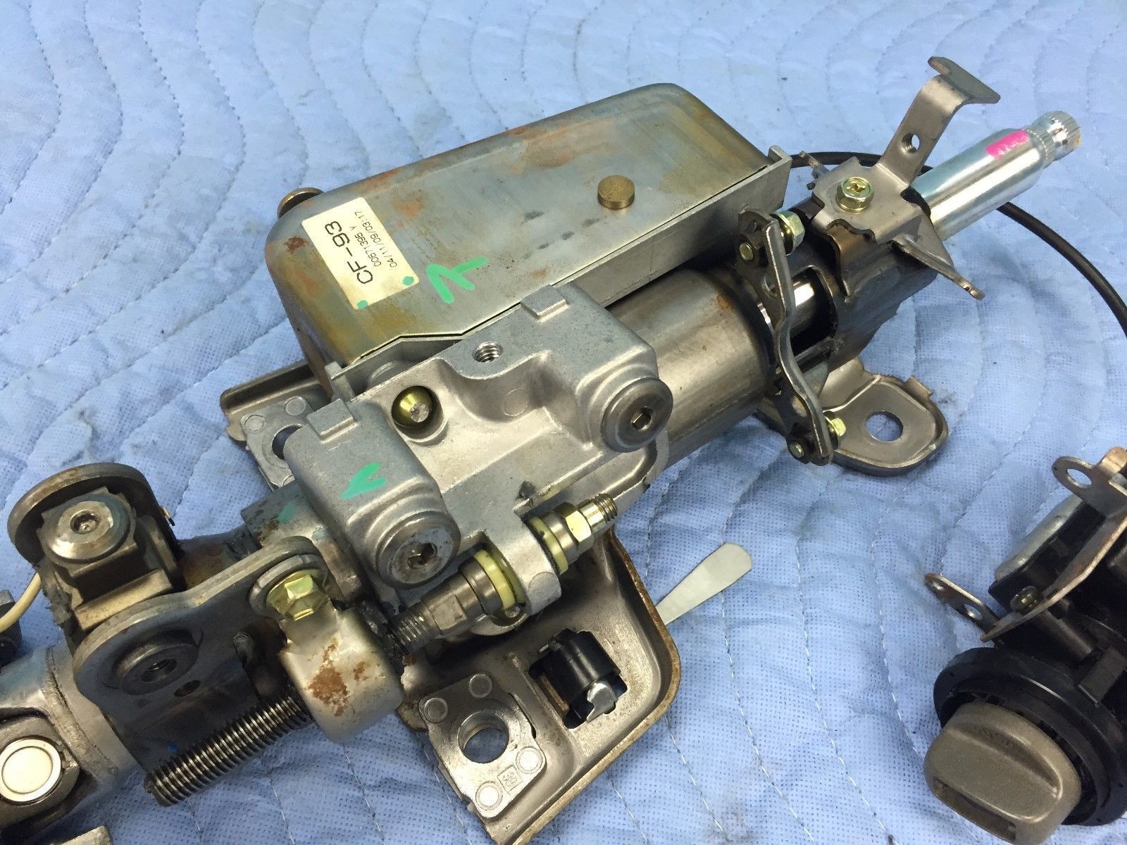

Also,
i was replacing my tilt motor today, and noticed that the date on the sticker on the steering lock actuator/ECU is fairly recent, 06/03/17, is that the manufacture date?
like in this pic, just below the CF-93 letters
does that mean that it was most likely recently replaced? and maybe wasn't married correctly to the vehicle's original system?
Old Apr 9, 2019 | 02:26 AM
  #54
BigBoomer's Avatar
BigBoomer
Joined: Mar 2018
Posts: 1,281
Likes: 385
From: ESSEX, UK
It is actually 04/11/09/03:17.
Japanese dates are backwards so that date is the 9th November 2004 at 03hrs 17 mins.

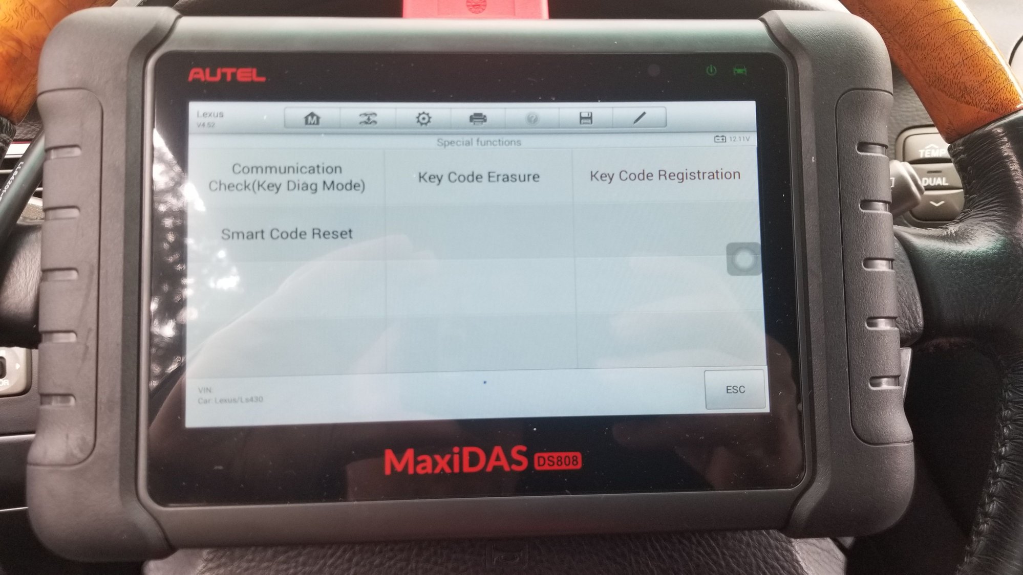

update: got my smart key system to work... i'm so proud of myself, lol
i bought a Autel MaxiDAS DS808 and tried to register a new key - no luck. tried erasing existing key codes - no luck, it would just spin and spin and spin...
only when i did the "smart code reset" i was able to program my key as new master key and now everything is working properly
it showed me that there were 4 master keys and 1 sub key programmed to the car - that was the max limit for the car so that's why it didn't take anymore new keys
only cost me $785 for the scanner...
