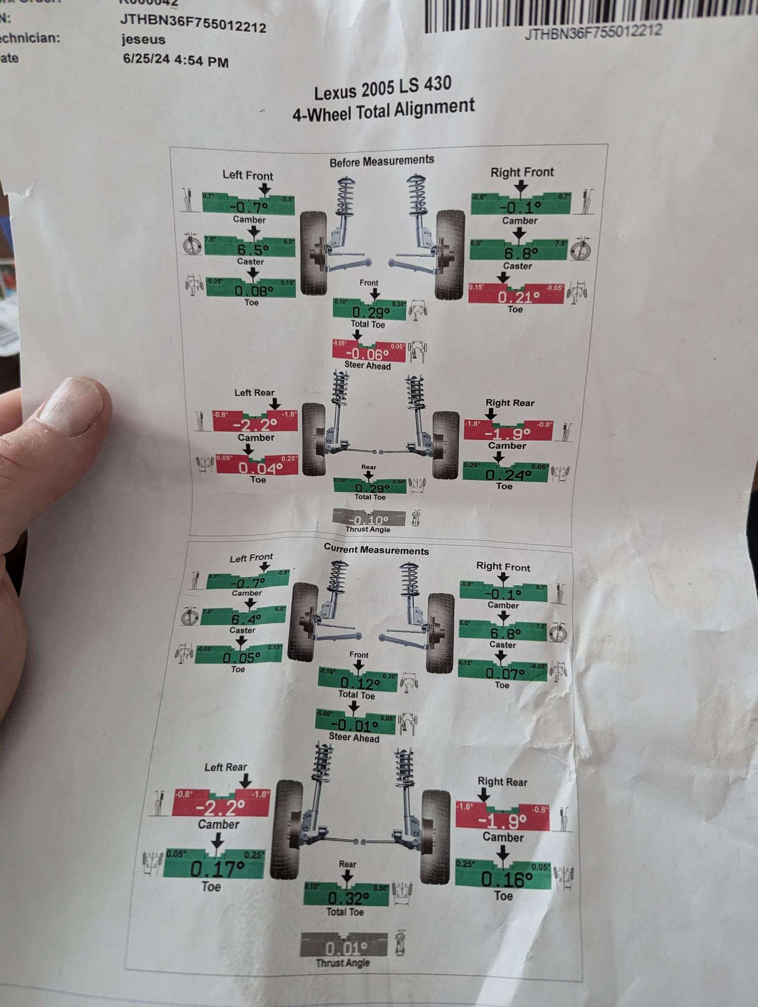

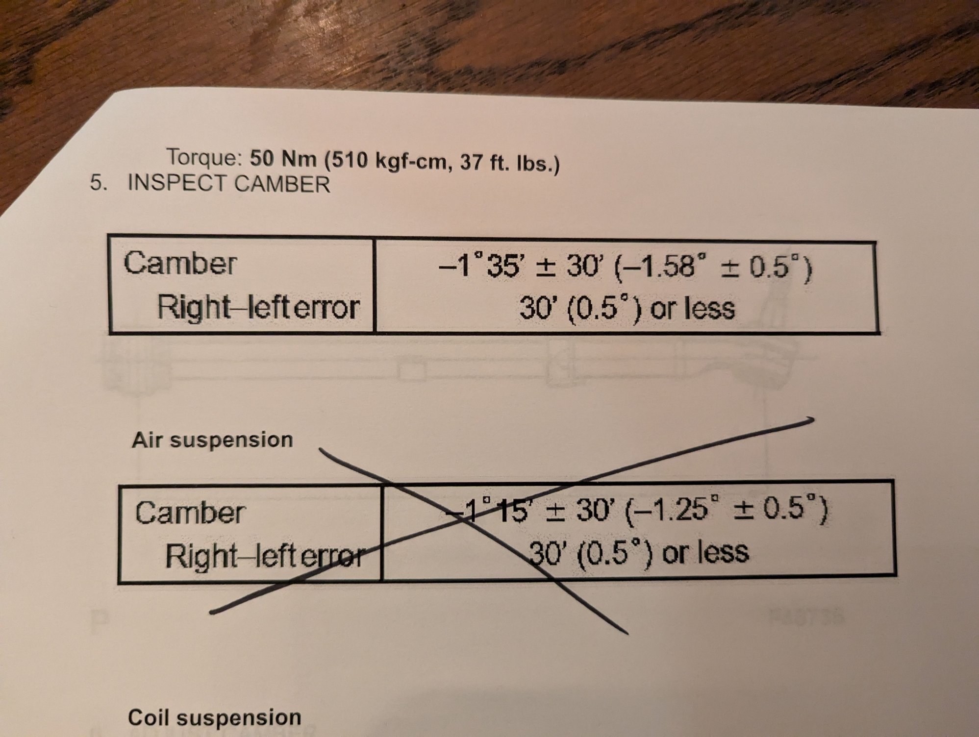

Thank you all for your helpful input! I found some more data I wanted to post for other users regarding this for future reference.
Here's three pics - two different sources of alignment data, one from ProDemand and another from Charm.li, along with a picture of my current alignment specs. Apologies for those UL owners, I crossed out the air-suspension specs so I would ignore those, as I have coils.
Prodemand gives a slightly wider spec range than charm (I suspect charm is pulling diagrams directly from old Toyota FSI manuals). I agree with pmesfun that it's probably not worth it to get that 0.2 degrees of negative camber ironed out with the use of camber arms at this time.
However next time I get the vehicle in the air I am going to measure the length of my camber arms to see which version of the three part numbers I have. If I am not already running the shortest option, I may consider going down one size in length eventually.
For those users reading that don't know, Lexus sells three different sizes for the rear camber arms shown in any parts catalog which at the time of posting this are still available for purchase new.

You crossed out the wrong one. :-)
From the bottom half of the 1st pic, the rear camber for coil suspension is -1.25° +/-0.75° or in the range -0.5° to -2.0°.
For air suspension that will be 1.58° +/-0.75° or in the range -0.83 to -2.33°.
The OEM camber arm lengths are available in 5mm steps (441.5, 446.5, and 451.5), or you could just fit these if it bothers you that much.
