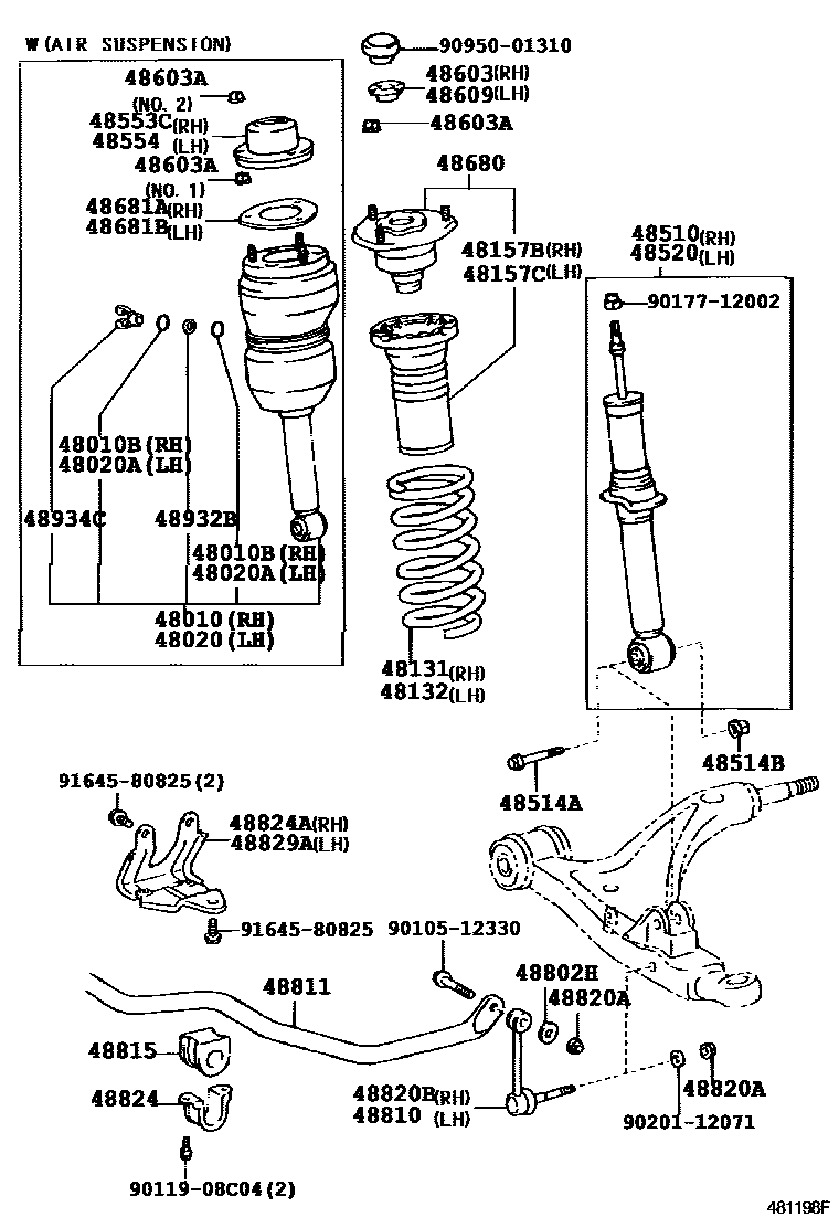

+1 on shopping the Japan retailers as you have the luxury of time. Partsouq, Amayama, Impex, etc.
Shocks/struts will be a hassle to ship from Japan. If they ship at all, you'll have to jump through some hoops to make it happen. Get them from Bell.

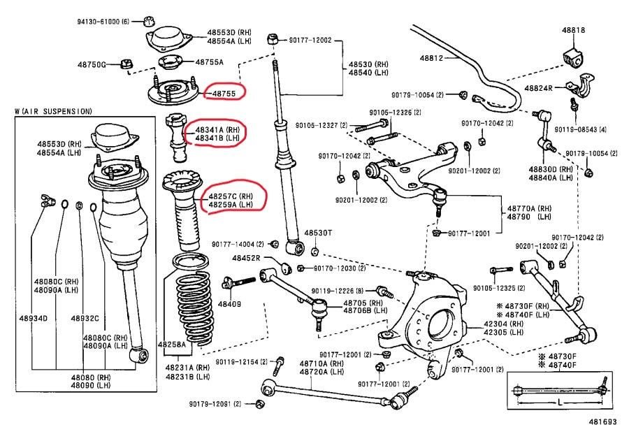

The front OE strut mounts come with bellows and a strut bumper all in one part number. The Japanese retailers sell them for almost half the cost of Bell. Shipping will be a bit higher but when ordering front and rear it's well worth it.
The rear strut mounts do not come with the extra parts you'll have to order them individually. See attached pic and be sure to order everything.
Aftermarket bellows and bumpers are available but they pale in comparison to the genuine parts.

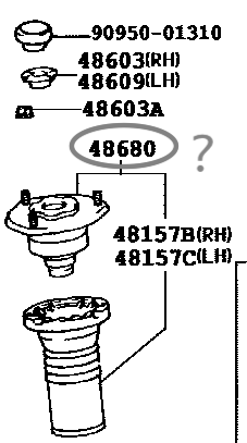

Thank you 🙏 Is this single part number you refer to 48680? So those 3 bits and pieces above it don't need to be replaced?

You'll get more help posting actual part numbers, otherwise people would have to look them all up themselves. Those appear to just be caps but I'm not sure. Nuts come with aftermarket KYB, usually not with OEM and they're single use nyloc so will need those also. Boot and bumpstop usually come with the mount

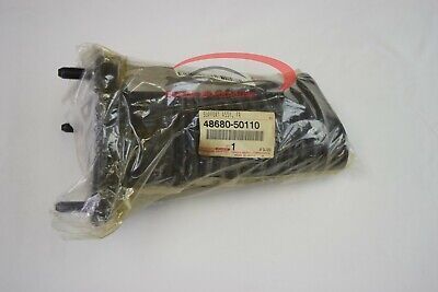

Yes
48680-50110
The only non-reusable part in question is the strut nut (90177-12002) which should come with the new strut.

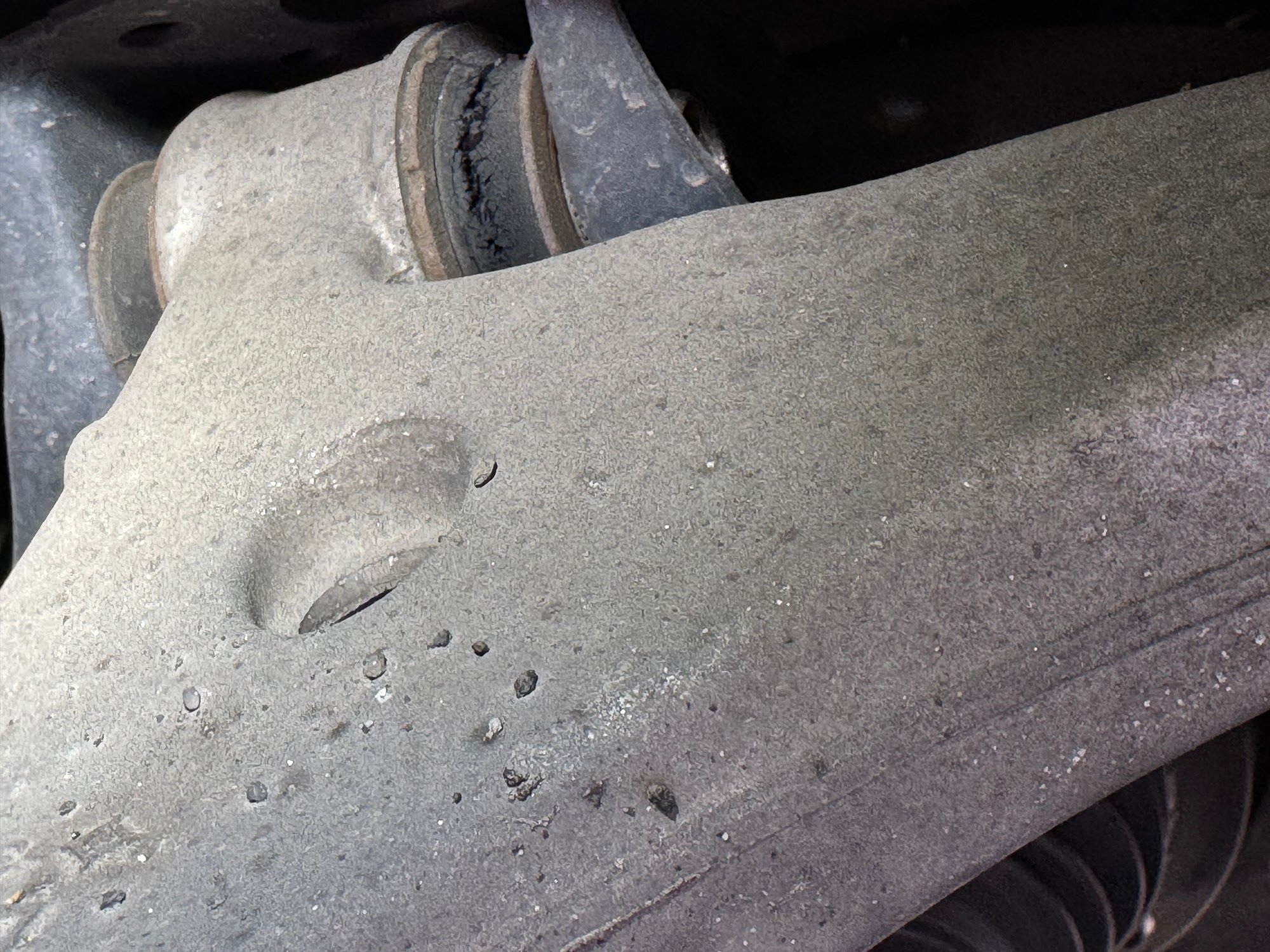

Discovered my rear control arm bushings are toast. Two different mechanics failed to notice this in inspections... 🤬
I can't find any part number for the bushings on these at amayama or bell lexus. Must these be replaced as a unit?
