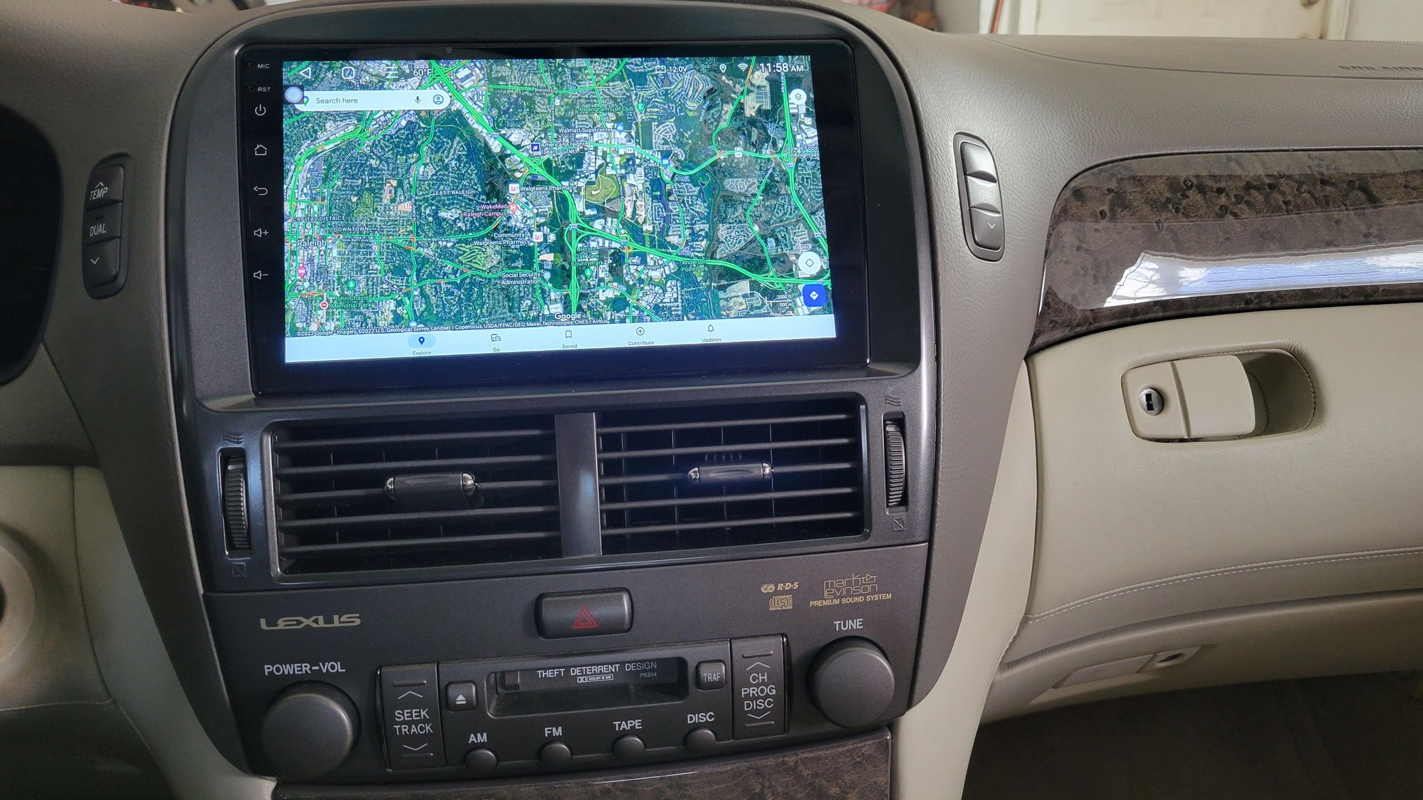

My 2001 LS430 UL brand new had a nav system that was mediocre at best. This unit brought an old car's electronics to current technology. It is basically a full android tablet with HD screen that can use any android app without restriction. Steering wheel controls and AC controls work and can be set to not boot up at turn on. It has bluetooth wireless carplay and android auto if want but with using the installed map app I never use it. It also has usb inputs and a cellular modem if I wanted a dedicated wifi cellular connection but I use the hotspot from my phone for unit to connect. For the radio I can use original or app radio for local stations which I like better. It has a factory look and very easy to install.
