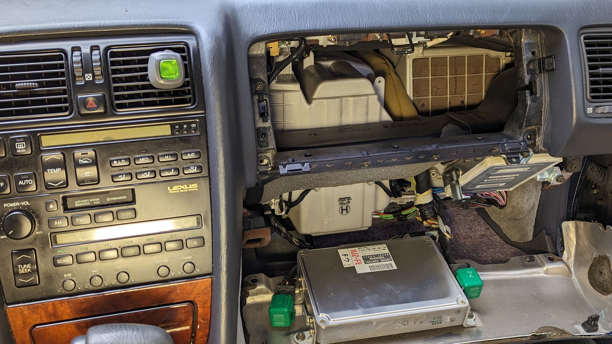

Greetings, so I did the ECU capacitor replacement and once I put it back in, after giving it a min to charge, the car started beautifully. It only seemed to fix my high idling.
Also noticed the diagrams showing the ECU location on my lexus was NOT in the vertical orientation but in the horizontal orientation under the passenger glove compartment. Weird.
