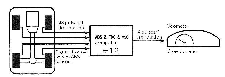

The important first step is to know how the speedometer and odometer are driven. See the signal flow below. VVT engine models do not get the speed signal from the transmission. Those get it from the ABS/TRC/VSC computer as is shown below. One tire rotation generates 48 pulses and the pulses are sent and processed by the ABS/TRC/VSC computer and then processed signal sent to both the odometer and speedometer. The process is to remove the noise and to get the average and then divided by 12. So the cluster unit receives 4 pulses when the tire fully rotates 1. I imagine that your ABS/TRC/VSC computer's system reset circuit is not functioning or the cluster unit has some problem.

What I can suggest is to observe those signals using an oscilloscope professionally. As an EE myself, I'd try to find the exact failing point using an oscilloscope, data analyzer, TDR and others.
Without measuring equipments, it will not be easy to troubleshoot. One simple idea is to replace the ABS/TRC/VSC computer or the cluster unit. Sometimes the signal line is disconnected and in this case it can be fixed rather easily using a multi meter.
