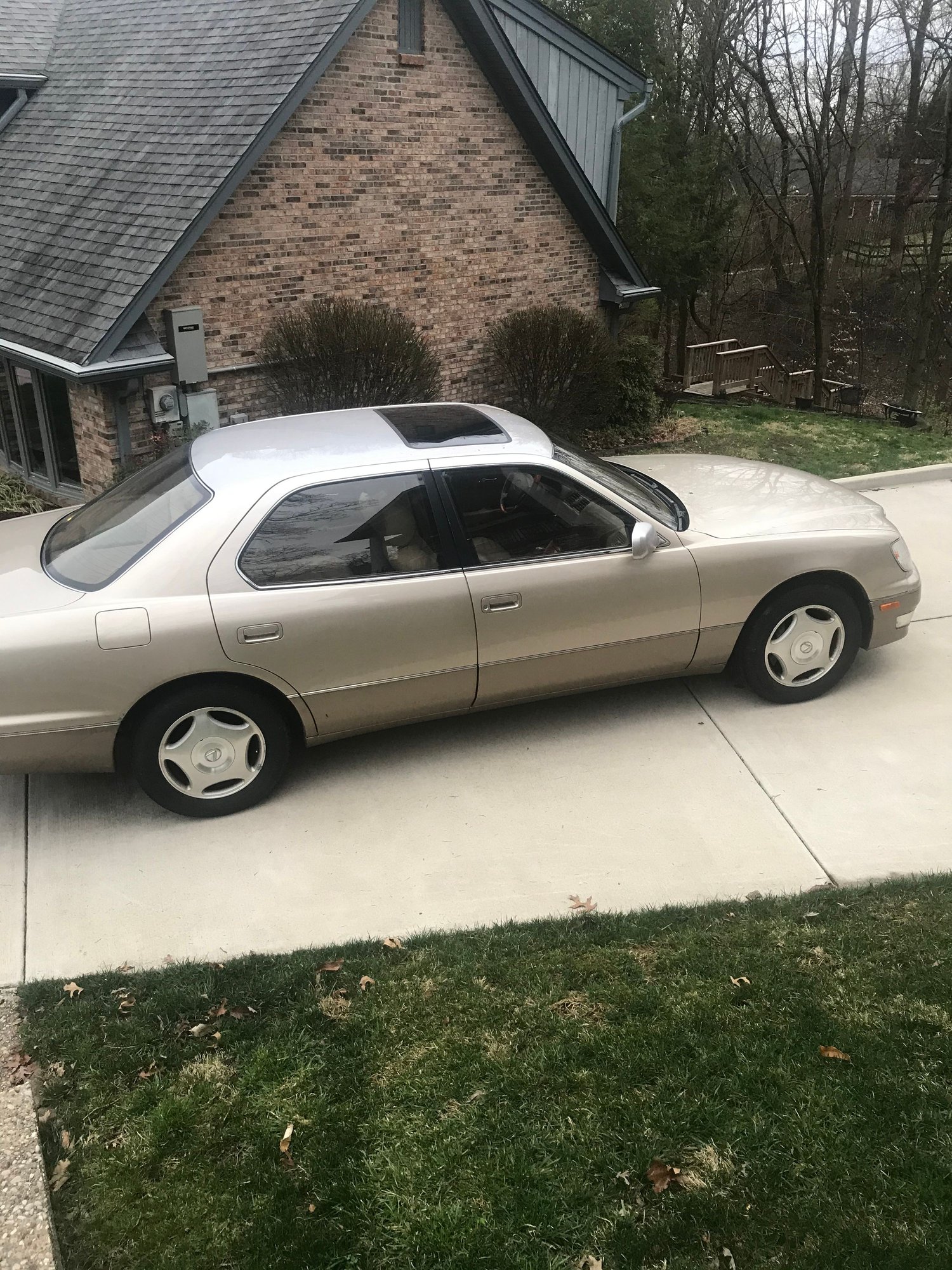

Picked up a 1998 LS400. The idea is to make it less “grandpa” like for my 14 YO. We will not be joining stancenation but I think we will probably drop it some and figure out an after market set of wheels as well. One of the first things I’d like to do is replace the head unit with a nice double din with CarPlay, for navigation and such. I’ve been reading here and I can’t decide if I want to replace the head unit and buy the part, can’t remember the name right now, that keeps all the other speakers and amp working or if I just start fresh.
The car had great dealer service history until 2012, the guy I bought it from has had it about 5 years so there is only about three years “lost”. It’s not perfect visually, front fascia has some paint missing from 177,000 miles, interior is very nice for a car of this age.
