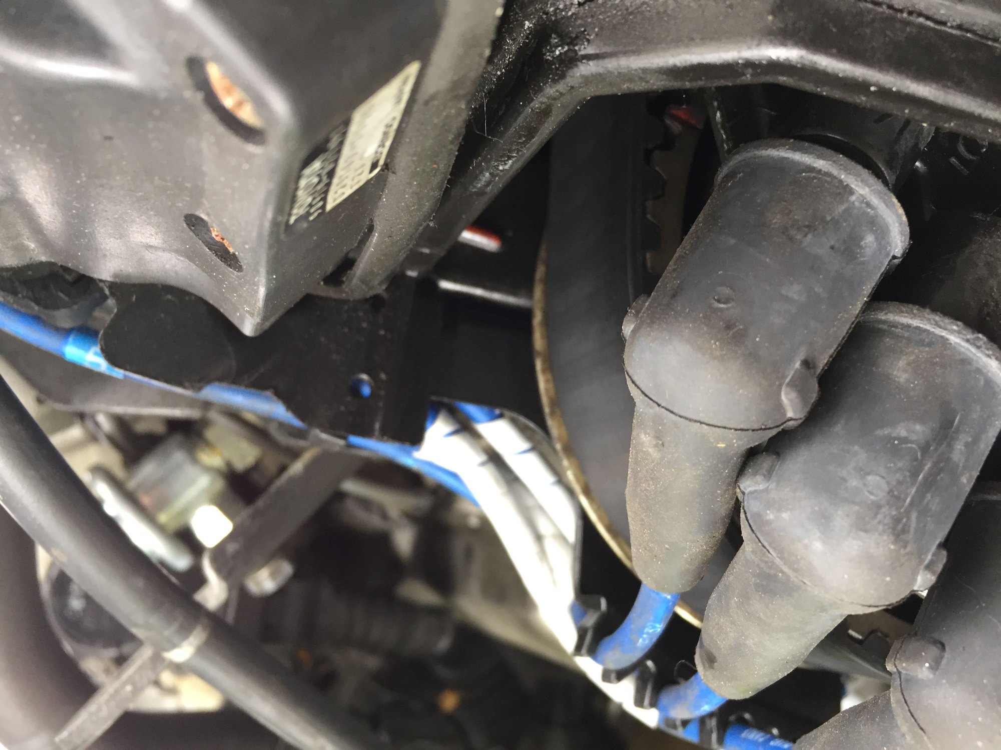

Is this timing off a tooth?
Subscribe
Jun 1, 2020 | 11:42 AM
Been experiencing a rough, low idle. Misfires. Did a timing job earlier. Was i off a tooth? Could one tooth even cause something like that? Thanks.
For reference this is at tdc

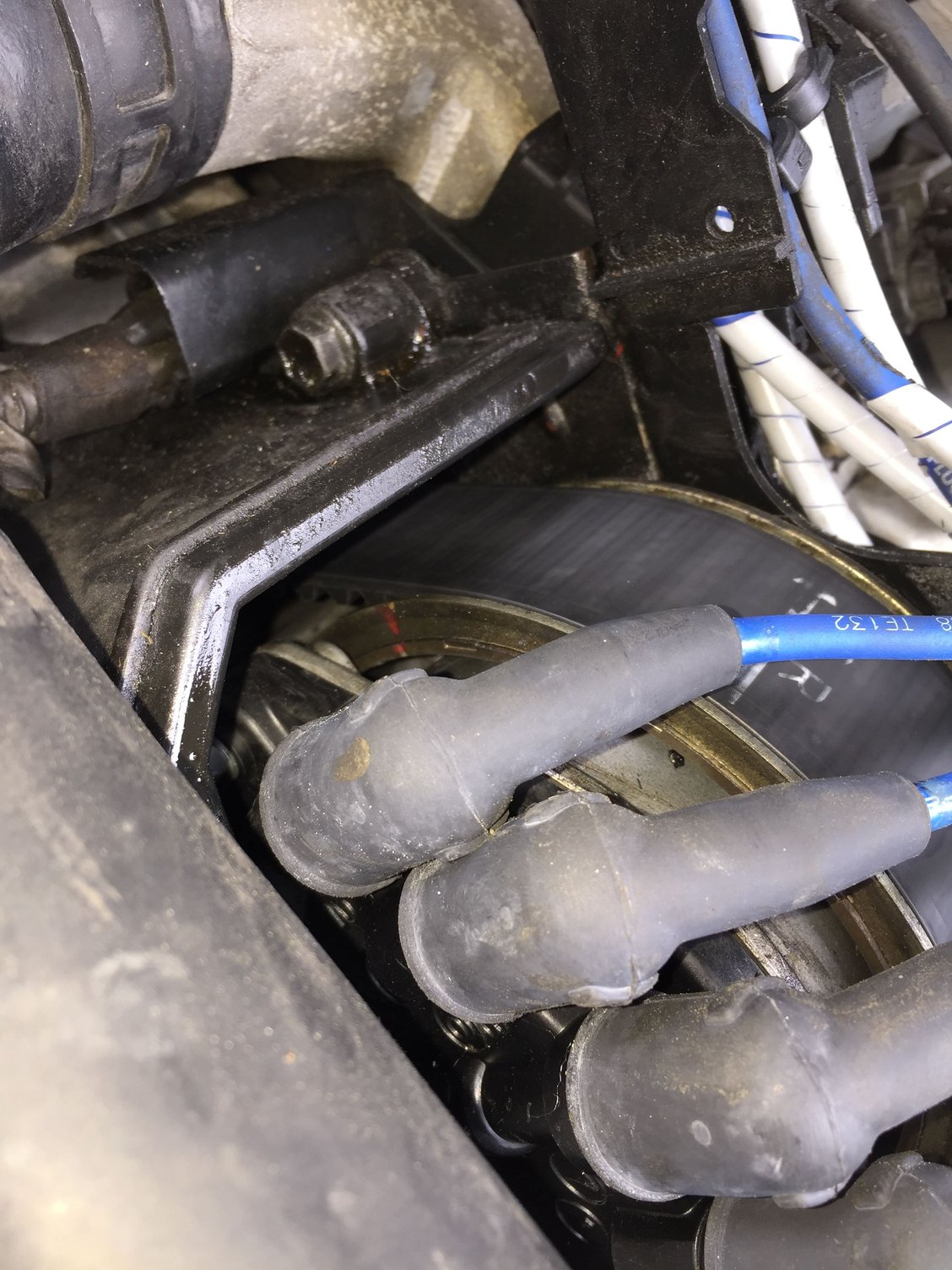

seeing as one of my photos was deleted on accident.... here’s both. Also, i have a track code 26

Jun 9, 2020 | 07:23 PM
timing is good too. turned out to be fuel system. while in the process of replacing the original fuel filter though, i stripped the nut. never using a box end wrench again. now i have to cut the fuel line and reflare. very sad!
