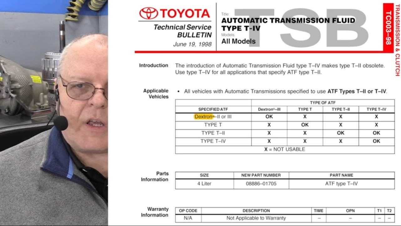

Toyota TSB Screenshot from video part 5 .
Type T-IV has been around for ~20.years now...
Engine oils have certainly evolved in 20 years.
It appears Aisin/Toyota offers an ATF AW+ that is only sold in Oceana and certain Pacific Rim countries.
The attached Aisin data sheet contains ATF AW+ as a replacement for T-IV, however it also states it replaces a range of other transmission fluids as well.
