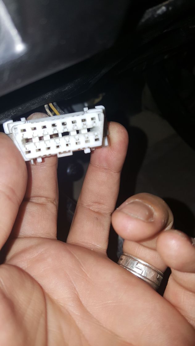

Talking Some pics might help
Originally Posted by PureDrifter
You need to check alternator. If the charging system is not working properly this error message may come on, as foretold by the owner's manual.
If this came on right after you changed brake pads it's possible that the wheel speed sensor (abs sensor) was damaged. Do you have any check engine lights?
thanks for your concern i hade the cheak engine light on since i bought the car two years back and onces it disappeared all by it on after one and the half years of driving . Replying to your message no i dont have a check engine light now and the problem existed before replacing my pads i have found so many ways in google to jump wires but mine seems all defrent As u can see there is no place to insert in the lower part as shown in most of the reset modes
Thats the crazy check vsc light

The VSC reset procedure is the 2000 LS400 owners manual. It does not involve jumping connector terminals like the procedure for the LS430. I had to follow this procedure a number of times after disconnecting the battery in the 2000 LS400 that I drove for 11 years.

Also, you do NOT use the jumping pin method to read OBDII codes in 95+ LS400s..
