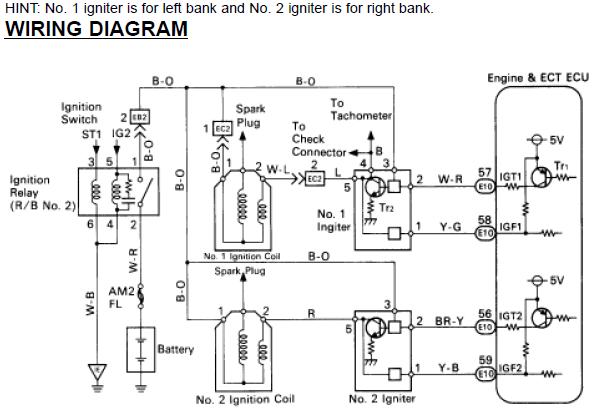

Found your code (Check engine light code = 14)
Circuit = Ignition No.1 Signal
Diagnostic Code Detecting Condition = No IGF1 signal to ECU for 8-11 consecutive IGT1 signal.
Code No. 14
Fail-Safe Operation = Fuel Cut
Fail-Safe Deactivation Conditions: 1 IGF1 detected in consecutive 8 ignitions.
Attached Thumbnails code 14-code14-15.jpg   code 14-code14-15_2.jpg   code 14-diagnosticchart_1.jpg   code 14-diagnosticchart_2.jpg

So far that's some really good info. Here's some more:
So as we already said code 14 is your ignition signal note making to the cpu. This signal is what tells the CPU a spark has occured. In this case, it is for igniter #1. If the computer doesn't get this signal, then the injectors won't pulse either. It has to happen 8 times in a row for the code 14 to set. Both igniters are located by the passenger fender.
They get their circuit completed through their ground to the body, so make sure you fasten them securely to the vehicle when you test them out.
There are some tests to do to backprobe the igniter and look through a labscope to see a sawtooth, but let's be honest here...you don't have such toys. It can be the igniter #1, the harness to it, the ground, or the computer itself has lost its ability to push out a 5v reference signal (not likely.)
