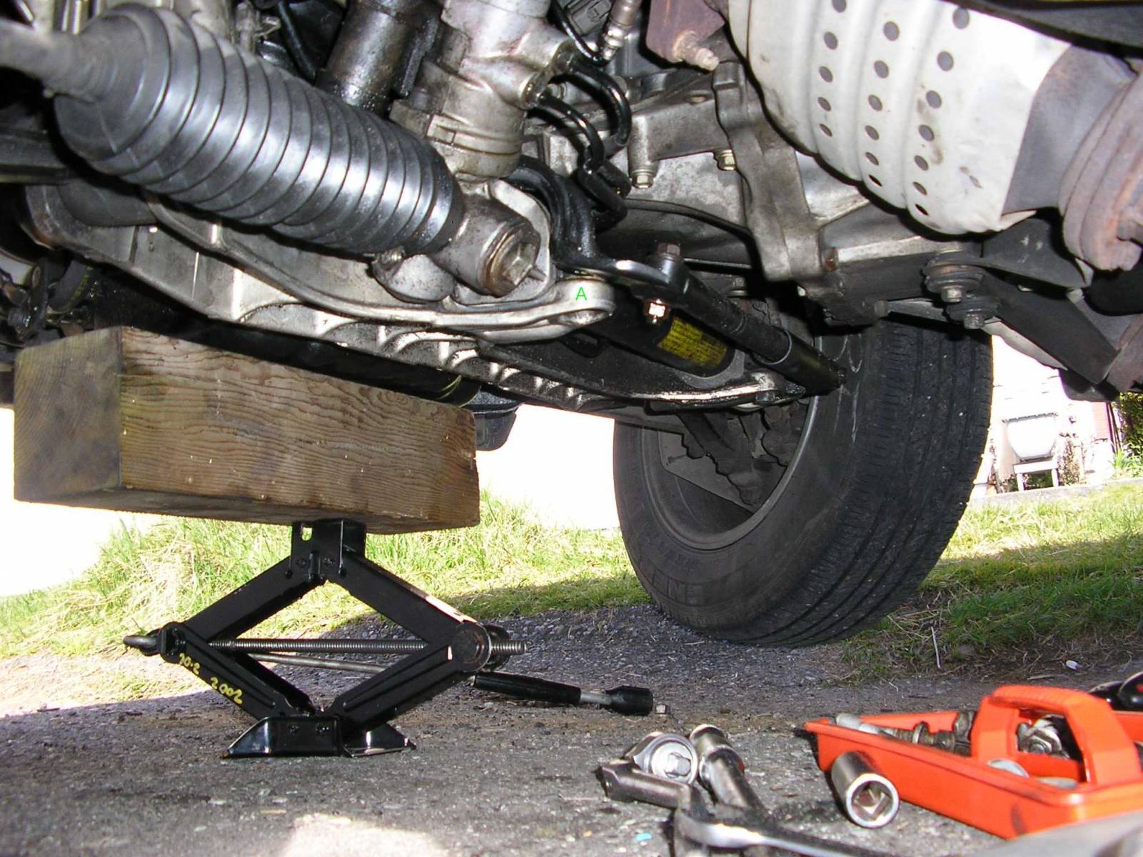

Support engine as shown at the oil pan. Dont let oil drain plug take the load.

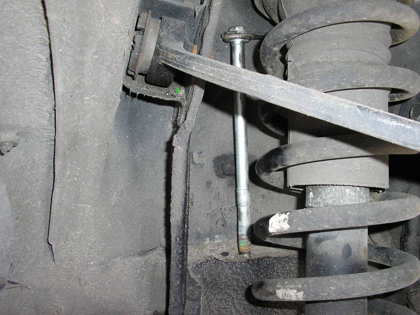

Completely remove 2 PS rack bolts on driver's side A and loosen 2 on passenger side.

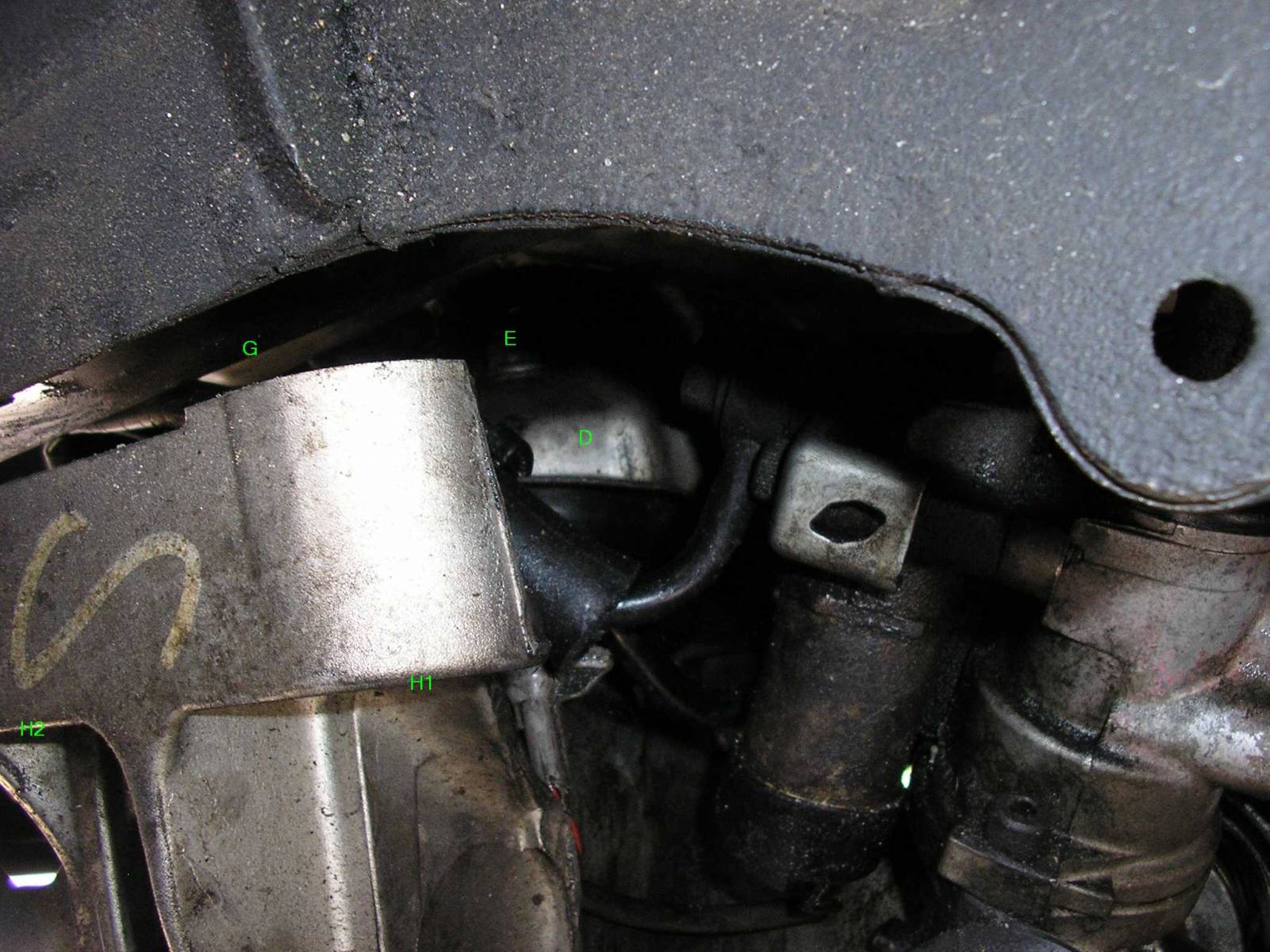

Now use 17mm deep to remove 2 drivers side nuts for crossmember and 2 for passenger side. H1 H2
(Two pics over below)
B is the grime that will fall in your eyes if you don't pressure wash all that area first. C is the bolt assembly for crossmember that you can just pull off to give you more room.

Crossmember will now sag down if not just pull it down about 2 inches G making sure nothing is pullin on it.

Lower the engine a little so that you can see the upper mount bolt E.

D is the mount heat shield. This looking in thru wheel well. Spray both the upper mount bolts well with WD40 and go for a coffee break.

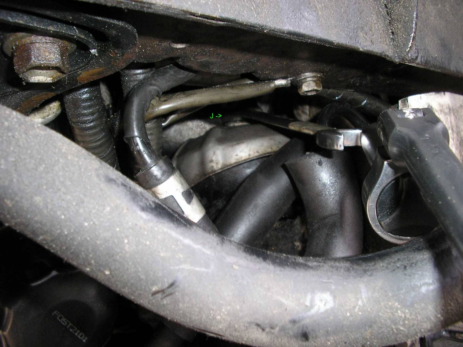

Now take the long 17mm ring wrench and remove upper mount bolt J. This took me 1 hour. DON'T STRIP THE BOLT! Use round end only. In the end i was able to loosen it by using a rachet to leverage the wrench as shown. Worked from the driver's side wheel well.
