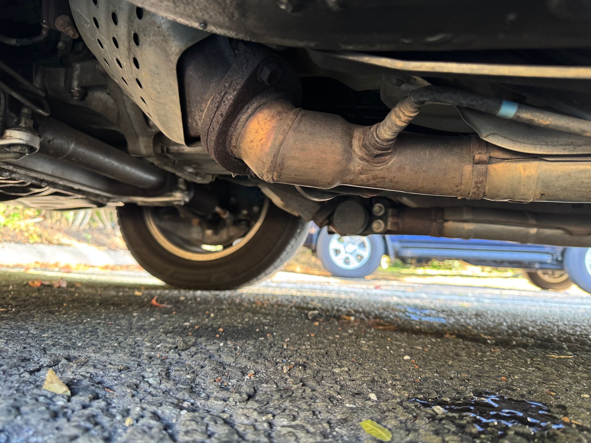

I have a 1995 LS400 federal emissions spec not CA spec as verified by stickers under hood and I believe also by ECU (my ECU is 89661-50224)
Chat GPT (I know, use with care and a lot of caution) insists that a 95 LS400 federal spec has no downstream O2 sensors. However, I see the below on both sides. Help me out here because I’m still somewhat new to this, what am I looking at?
I have an OBD2 style port, however consistent with my research it seems to pull limited data and the car doesn’t seem to be full OBD2. The EVAP monitor is “N/A” and the CAT monitor likes to stay at “INC”.
At idle today after driving for a bit, reading live data my short term fuel trim based on B1S1 and B2S1 were each 0.8%. The reader showed short term fuel trims for B1S2 and B2S2 at N/A and 99.2 percent respectively, which chat GPT insists is garbage data / hallucination.
There are no CEL codes and the car drives perfectly (recently did complete overhaul and tune up)
Any thoughts are appreciated regarding what I am seeing below.

I haven't read your whole post yet, but ChatGPT is wrong and you are correct
Your car has 4 O2 sensors - 2 upstream and 2 downstream
The one in your photo is the bank 1 downstream O2 Sensor
Diagram:
https://www.amayama.com/en/catalogs/...y-computer-337

In my opinion, that ChatGPT explanation is misleading and does not apply at all to the LS 400. It does however apply to some other cars from the period
Since 1989, all LS 400 models had upstream and downstream O2 sensors on bank 1 and bank 2. This includes CA and Federal emissions compliant versions
I read some more of your post now. In 1995, the car had basic OBD-II, which was expanded in 1996 onward. This would be why your data may not be as detailed
https://www.clublexus.com/forums/ls-1st-and-2nd-gen-1990-2000/505727-95-ls400-obd-i-or-obd-ii.html#post5542431
I would consult the service manual. There are procedures for checking O2 sensor health specified in there. I will see if I have a chance to look that up soon..
