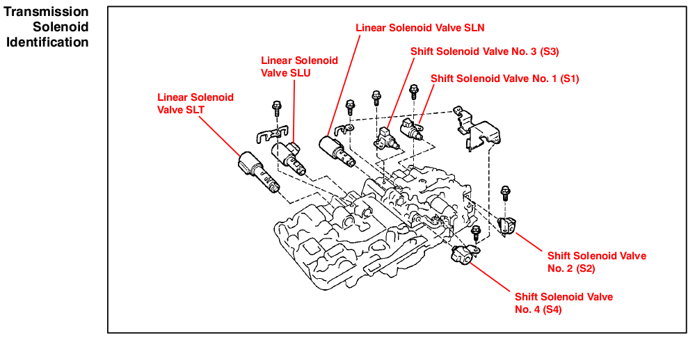

I have the CEL on for the transmission shift solenoid e, does anyone have a part number and which one it is so i can take it out please? any information would be much appreciated

See attached files both the drawing and the pdf file below.
The Shift Solenoid ”E” is the Linear Solenoid Valve SLU. You must have a code P0770.

35280-50010
This is the lock up control solenoid. I would not recommend an aftermarket part, go with OEM on this one. If you have time to wait for shipping you can save a lot of money ordering from Japan via Amayama.
