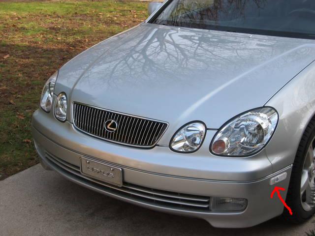

Are you talking about this side marker?

huh...rear bumper - side markers???
if your talking about the one gunru pointed to ..its through the fog lights...

I did my front side markers through the wheel well by just pulling back the wheel well cover.

I did mine like TexasGS said. Just take a bolt or 2 out and peel some of the black plastic back, then they're right there.

its easier through the fog light... 2 screws each fog and you have access...
