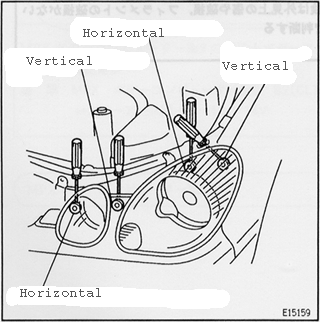

Hello everyone,
I was wondering if someone knows how to adjust level of your headlights for those who doesn't have auto leveling feature in their cars.. low beams and high beams (if its any different)

Use a long Philips screwdriver.
You'll never imagine how much this photo helped me when me and my dad braved the cold about a month ago and aligned my headlights.
-Anthony
