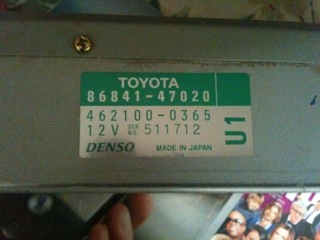

This is my new project to upgrade 2000 RX 300 (no navigation only pioneer premium sound system) with 2001 RX OEM used GPS navigation. I got used OEM 2001 RX navigation. First of all I need electrical manuals for Navigation system. If any member has it please feel free to share with me. I wants to add Iphone, Ipod, backup camera ( boyo VTL 402c) with the GPS screen, service records etc. Here is some pics of used 2001 navigation. I think my RX doesnot come with navigation pre-wired from the back of the trunk to the front display. How I get the harnesses, connectors, cables? Any good sources?
Attached Thumbnails Gps navigation installation help 2000 rx 300-nav-screen.jpg   Gps navigation installation help 2000 rx 300-nav-screen-back.jpg   Gps navigation installation help 2000 rx 300-navigation-dvd-drive.jpg   Gps navigation installation help 2000 rx 300-nav-screen-model-no.jpg   Gps navigation installation help 2000 rx 300-nav-dvd-drive-model-no..jpg

This is NAV screen from 2001 RX 300. The red arrow(box) is the power source connector? Wires color are: 1.Green, 2.black and white, 3.red, 4. red with blue strip and 5. grey. Is it possible to power up the screen with out connected to the gps dvd computer? There is two more connections (red line) blue, and the right is white. I believe the the small blue connections for gps dvd ecu. So what is the other right white connection for? If any members has the technical lay out please e-mail me or fax me. E-mail: gazi0001@gmail.com
Attached Thumbnails Gps navigation installation help 2000 rx 300-screen-connections.jpg   Gps navigation installation help 2000 rx 300-wiring-harness-short-with-connector-screen.jpg

Here is the following updates: Red line small blue 10 pin connector for video source from the gps ECU. The 14 pin white connectors for following: 1.Speed sensor-violet/white, 2. diagnostics- pink/black 3.power antenna-black/white. But other colors: Yellow, Blue/white, Red/white in 14 pin white plugs couldnot figure out. The 8 pin blue connectors at the left (pics) colors are:solid green,black/white, Red, Grey and Red/blue couldnot figure out. I hope all the GPS Guru's in the forum will come forward.
Attached Thumbnails Gps navigation installation help 2000 rx 300-14-pin-white.jpg   Gps navigation installation help 2000 rx 300-8-pin-blue.jpg   Gps navigation installation help 2000 rx 300-8-pin-blue-wires.jpg
