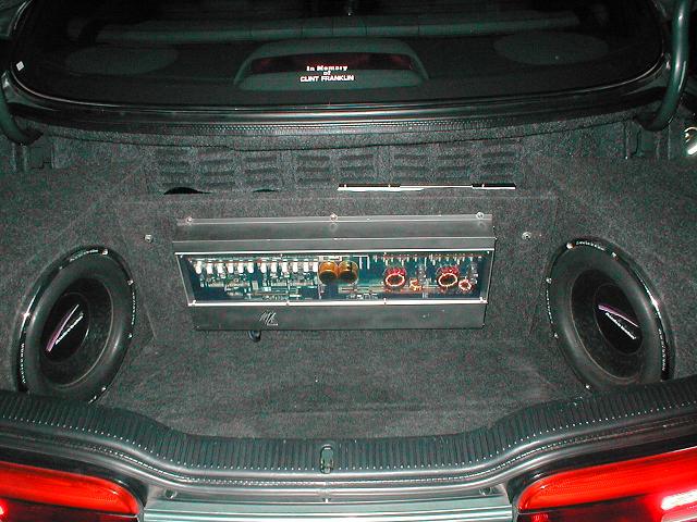

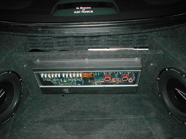

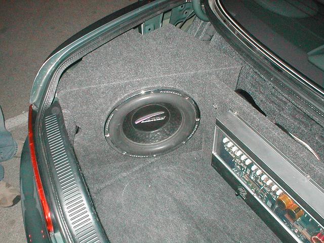

I don't know anything about isobaric setups, and don't claim to. Having said that, this is not an isobaric setup (lol). In the pics, the subs are facing each other, but when I get the project finished, they will be angled towards the rear of the car. I thought that same thing about facing each other, so I avoided that as best I could. The main reasons I went with this setup is 1)I have 2 subs, not 1; 2) not enough room around the gas tank to make something there (these are SPL subs and need lots of room); and 3) I HAVE to keep my spare tire in place and accessable.
The sound enters the cabin of the car through the stock sub location - I took it out so it acts as a giant port to the trunk. I will also port the boxes on the top or back to allow more sound to come through.
I havn't done any dynamatting (yet?). Before I started this project, I had a massive ported box in my trunk. It sounded great inside the car, and from the outside it wasn't all that noticeable until I cranked it up. There aren't any rattles that I can hear, with the exception of some plugs that I did my best to secure. I may dynamat this summer if it starts to bother me.

engin_ear is very correct.
also, If porting get a simple parameter guide to make proper ports for sub and box size. just poking a hole in the box for a port will not do.
Its always best to build sealed enclosure for first timers. They also sound best in SC trunk without going through too much trouble.
great start,very nice looking so far
As far as building to specs, I'm going on memory - Audiobahn's website (audiobahninc.com) doesn't have specs for boxes and I don't really know where else to look for them. If I ever find my manual for the subs, then I will look in there. As of now, they're AWOL.
If memory serves me, the box should be between 1.5 and 2 cubic inches. Based on PerryInLA's calculations for his box, I estimate I am near the 1.8 ft^3 mark... but that is a VERY rough estimate. I also believe the port size is to be 3" to 4" in diameter. I plan on making it around 4", and adding some sort of "deflector" inside the box (does that make sense? I can't tell...). I'm still torn on where to put the port - on the top or on the back side. I'm leaning toward putting them in/on back because I think it will force more air into the cabin, and it obviously won't be "firing" into the trunk lid. Any thoughts on this?

I walked inside from the garage at exactly 5:48 AM... the project is finished with the exception of some minor tweaks. If this doesn't make sense, then ignore it cuz I'm really tired. Pics to come tomorrow...
Finished... I have a few little details to wrap up, but it's done for the most part.

I'm sure there is some cancellation, but not too much. The subs face the rear of the car more than the pics show. But with all of the constraints I had, it's the best I could do.
