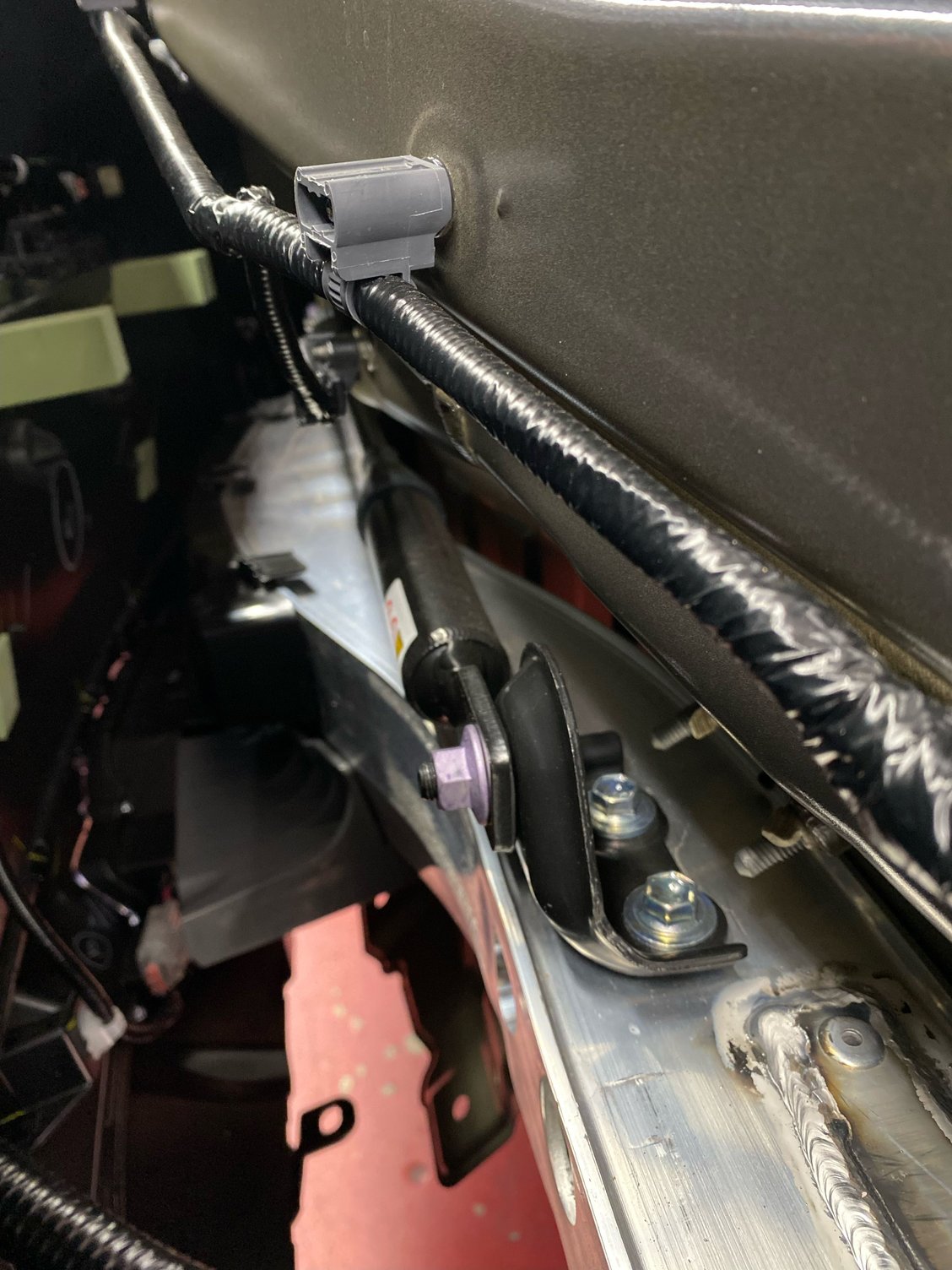

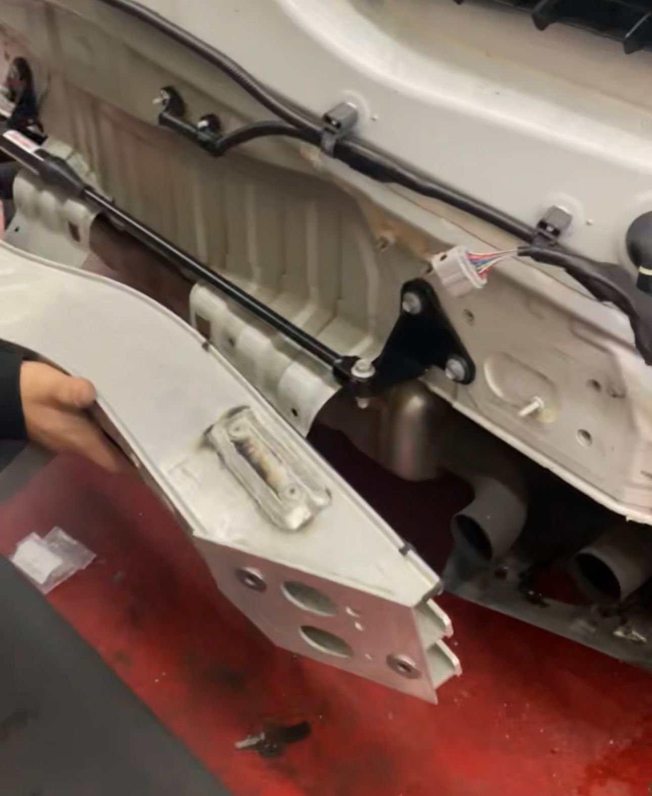

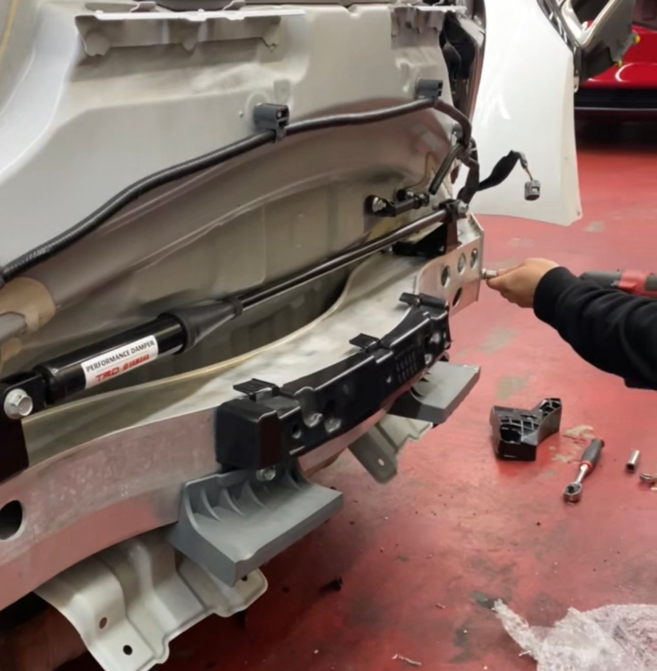

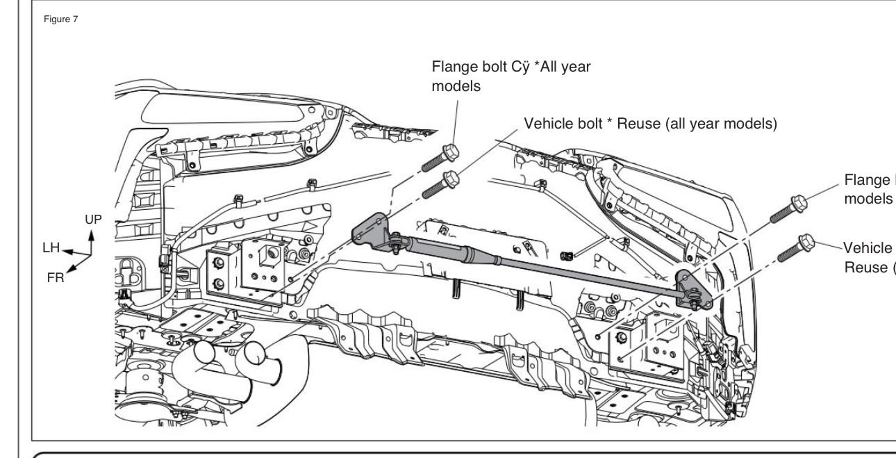

Longtime lurker making a post to give you guys a heads up about the TRD dampers for the LC500. I ordered the front and back set to install onto my 2018 Coupe to reduce vibrations over choppy roads and while the front dampers installed perfectly, the rear dampers did not fit. The TRD manual shows how it's supposed to be bolted on to existing thread holes on the frame but doing so prevents the rear impact bar from being installed back onto the car. My auto guy spent a good couple hours trying to figure out if there was a certain orientation or maybe the instructions were read wrong but nope, it will not fit unless you decide to not install the rear impact bar back on.
By dumb luck there was another LC500 in the garage undergoing a full wrap job that had the bumpers already partially removed: a 2021/22 vert with the dampers already installed. The vert had the dampers installed directly onto the rear impact bar rather than in front of it like the TRD instructions. After looking at how the OEM was installed, my auto guy bolted the dampers on in a similar brace setup by drilling/threading the damper support frame onto the rear impact bar. If it weren't for that vert being in the shop at the same time it would not have been figured out and I'd be stuck trying to get a refund from Japan. Big thanks to him for coming through, if you need a rec for a good auto/body/wrap shop over in Los Angeles, I'll be more than happy to refer him if you PM me. I have some example pics in case anyone else runs into the same issue.
If you really want the rear dampers on your 2018/19 model, it's probably better to buddy up with a Lexus Dealership and see if they can order you the OEM part directly. You would also need the 2021+ model rear impact bar to go with it with preinstalled threads unless you want to drill holes yourself. Keep in mind this doesn't include the front dampers that come from the TRD set. I don't know how much the front dampers matter exactly as I couldn't test one without the other but with both installed, they do a noticeable job reducing micro jutters over choppy roads/bumps. No difference in handling from what I can tell so if you already love the NVH/Comfort of your LC, it's probably unnecessary.
TRD instructions showing how the rear dampers are supposed to be installed.
With the dampers in place, the rear impact brace cannot be placed back on.
The OEM install example on the convertible being wrapped in the shop.
The macgyver solution to fit the damper on in a similar setup.

Thanks @Foamy for the detailed and important clarification. Mine shall be installed within the next few weeks.
I wonder if you double checked the part# on the dampers to make sure you received the ones for the coupe as they might have sent you the dampers for the convertible by mistake!
Also, do you have pictures of the final product in your car front and rear after all the work is done?
Thanks again for sharing this info. Much appreciated

The possibility of being given the wrong part did cross our minds but looking at the packaging and etc., it all matched the coupe spec. Another thing too is that the way the rear brackets are designed, it wouldn't have fit the convertible in the shop. Out of curiosity I looked over the diagram for the hybrid model and the rear impact bar for all three variants are pretty much the same except for the later year cars having the damper installed on top. It was puzzling and after reaching out to the vendor, they couldn't give me an answer, just an offer for a refund. We decided to just stick with the modified OEM install as it looks like as long as the vibration dampers are installed onto the frame in the vicinity, it should do its job. Both the dampers from TRD and the OEM look the same and are made by Yamaha so it's likely the same part for the rears.
I would look at your brackets in your package, if you see a similar triangular design with the welded wedge, there's a good chance you're going to run into the same problem with the coupe. Unfortunately this is such a niche part for an already niche car that we're gonna be the guinea pigs.
Regarding the pics, you can't see rear dampers at all as it sits above the impact bar and is covered by the bumper. The bumper cover and etc. went back on over the installed dampers without a problem in that configuration. You can see the front dampers through the grille, here's a pic:

Yeah I was wondering if the Japanese market has a different design for their LC's in the rear. TRD does state it's essentially JDM only. Maybe the rear impact bar design is a US/EU thing for crash/safety regulations but it's difficult to figure out unless you know someone who has a Japanese market LC500.
If the rear dampers are installed as pictured in the manual then yes, you can technically run both that and the OEM at the same time. The rear dampers originally would've sat below the rear impact bar, the OEM dampers would've sat above it. You can see the difference between the 2018/2019 rear impact bars from the 2020+ below.

Looking at the pics and specifically the one above if it's mounted at both ends to the same portion of the car how can it affect anything?
Old Jan 22, 2023 | 05:42 PM
74Sprtstr's Avatar
74Sprtstr
Joined: Apr 2020
Posts: 547
Likes: 222
if intended as a stiffener, it would inhibit torque between the attachment points
