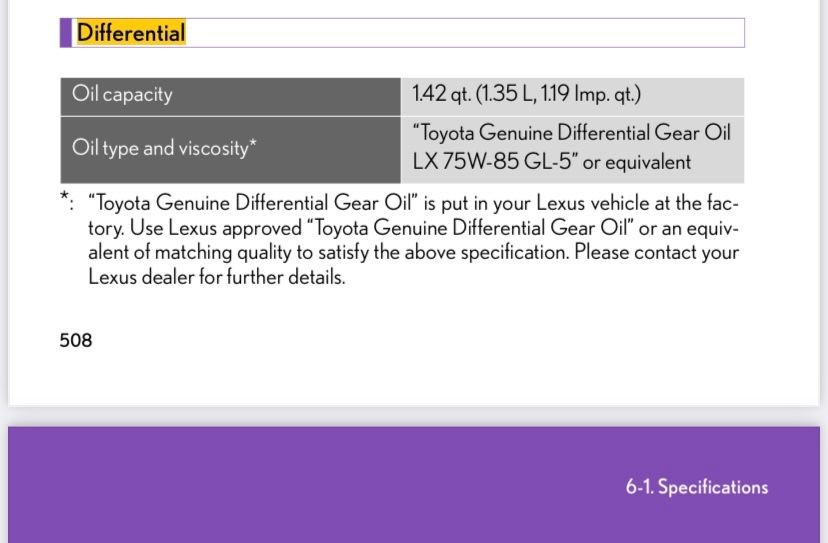

So I took the car to Lexus for ATF fluid and diff oil change. Now have a vibration or grinding/shimmy type sensation when turning hard left or right at walking speed. Straight line feels normal. It shifts gears very smoothly and I feel like the vibration is coming from the rear axle. The invoice says they used c0bba-80w90 hdplus80w90 gear oil. Is this wrong oil? Mine is MY2011. I'll be going back to lexus obviously but would like to be well informed before I do. Thanks.

The correct oil viscosity for your differential is 75W-85 GL-5 or equivalent. For the Transmission it’s Toyota Genuine ATF WS. I just did the diff service myself on my 2012. No issues.

The diff oil needs to be LX variant not the LT variant. There must be additives or something in the LX variant that the 2011 LSD Torsten unit needs to stop this grinding/noise sensation.

Yes I would make sure they followed the FSM and/or owners manual…
Sounds like they dealership used their in house 80/90 gear oil.
Minimally, it should be synthetic equivalent if not the OEM stuff..

Update: dealer replaced with the proper LX type diff oil and now grinding/vibration is completely gone. Didnt see any metal shavings on the magnetic plug bolt either so hope all's good.
