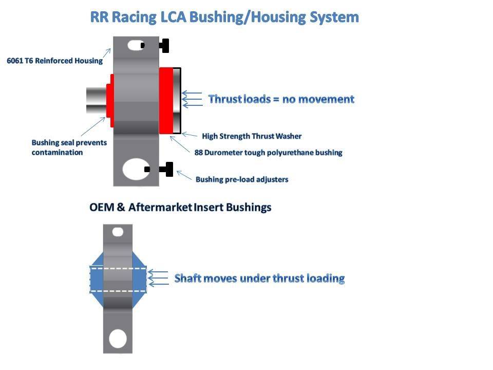

Hi all, seeing the comments I’d like to clarify. There is a much greater difference at play here than just color or hardness (although for the record, we offer a softer street version and harder road & track version)
There is a HUGE difference in function of the Superpro versus our USRS.
The reason we use preload bolts is that we are preloading the large washer against the bushing, which virtually eliminates axial movement of the lower control arm. Without this, the lower control arm is free to migrate backwards (just like OEM bushing) under hard braking which causes the front wheels to toe out:

Fair enough, but you're preloading against another rubber bushing in the front. Kind of seems like 6 of one, half a dozen of the other to me unless you do something about the front bushing too. I've run Superpro poly, and now Figs solid both with Superpro poly in the front. The difference from OEM to Superpro was pretty amazing, and if you are OK running zero to 1/16" out for front toe, your tires will be fine. This is in deep contrast to the OEM bushings needing at least 1/8" toe in to wear the front tires evenly. Going poly/poly or solid/poly also means assembling your front suspension just got 100 times easier because there's no need to preload the corner before tightening the pivot bolts. HUGE YEAH BABY for that one!
As long as there is something squishy, there's going to be movement. Superpro and USRS will both deflect under hard use, but not even slightly like the OEM Krispy Kremes. If you're serious about deflection, you'll need to go solid. If you want better wear on your front tires, run either USRS or Figs Superpro and you'll be leagues ahead of the OEM piece. With a decent alignment, you'll track straighter under hard braking, and your inside edge wear problem will go away. AMHIK.
