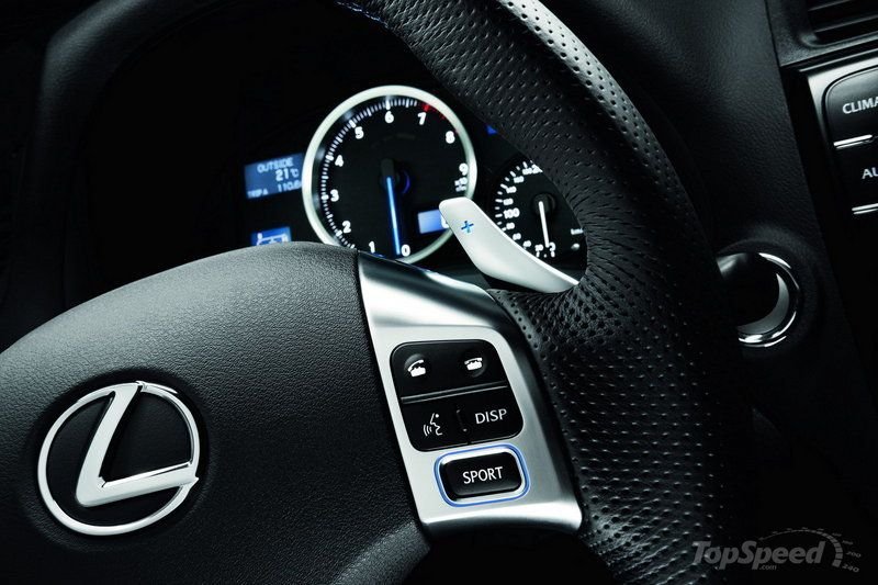

Don't get me wrong I want to keep the Sport button in the steering wheel, I just want to get the black covers with the same texture as the airbag on for more "Classic" look as I think the all black with blue bottom wheel is the most suiting for this interior,
it looks like the buttons are screwed to the cover from inside so maybe it can be separated, I just hope the Sport button and the radar button share same size, shape and location so it would be a straight swap

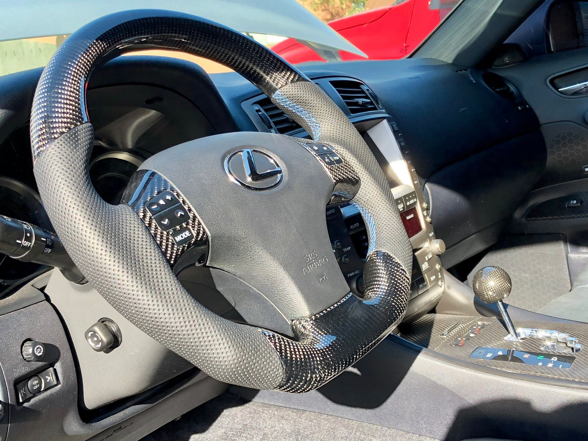

I went ahead and switched everything to black CF including my paddle shifters.

99% sure they're both 10 x 20mm. I measured the black housing (the outline of the PCS button is molded into the unit, just not punched through) and it measures the same 10 x 20mm the Sport button does on the silver switch set up.
Removing the covers is stupid easy once you have them off the steering wheel, and you could either swap covers or swap switch buttons very easily.

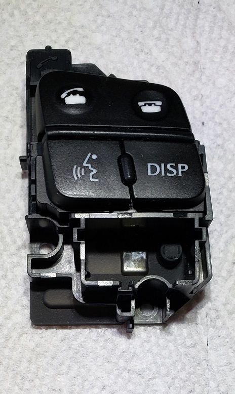

There is a raised lip inside the cover to help guide you on exact positioning. I would suggest a scalpel or X-Acto knife to carve this out and trim to fit. There is a bevel to the cutout you'll see when you remove the silver switches, keep that in mind when you cut the hole for the new one. I have some practice with slicing Lexus instrument panel plastics, and I've found a #4 scalpel works really well. It also makes trimming to fit pretty exact. A rotary tool, like a Dremel, might be a little challenging. If I were going to try it that way, I'd suggest fixing the tool and moving the work, not the other way around. Just my preference, and I've done a fair bit of die grinder work in the past.
This is the inside of the cover, you can clearly see the ridge in the plastic outlining the position of the PCS switch.

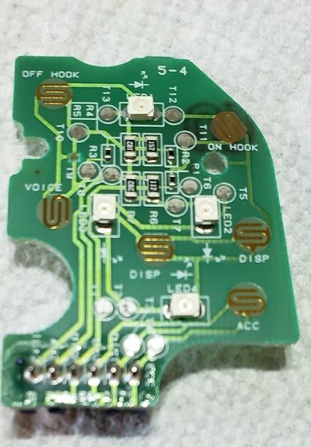

This is the switch electronics board. As you can see, there is only one design, and even when the PCS or Sport switch is not present, the switch pad is there underneath the covers. If you wanted to change the illumination color of the PCS/Sport switch, you would only need to replace the LED at the bottom of this board with a different color. I was thinking it would be pretty cool to make it blue like the outline around the switch on the bright late model switches.
Here you can see the open spot for the PCS/Sport switch. It is an exact mirror image of the Mode switch. Also note the silicone rubber nub sticking up where the PCS/Sport switch would be. Quite literally, everything is there except the one plastic piece with PCS or Sport on it.
This is the silicone rubber pad. There is a mystery nub near the middle of the silicone rubber pad. The electronics have a switch pad underneath, but there isn't anything in an IS F that would press this nub. The electronics would make one think this is a redundant Display switch. Might be interesting to plug this in and see what it does for real.
