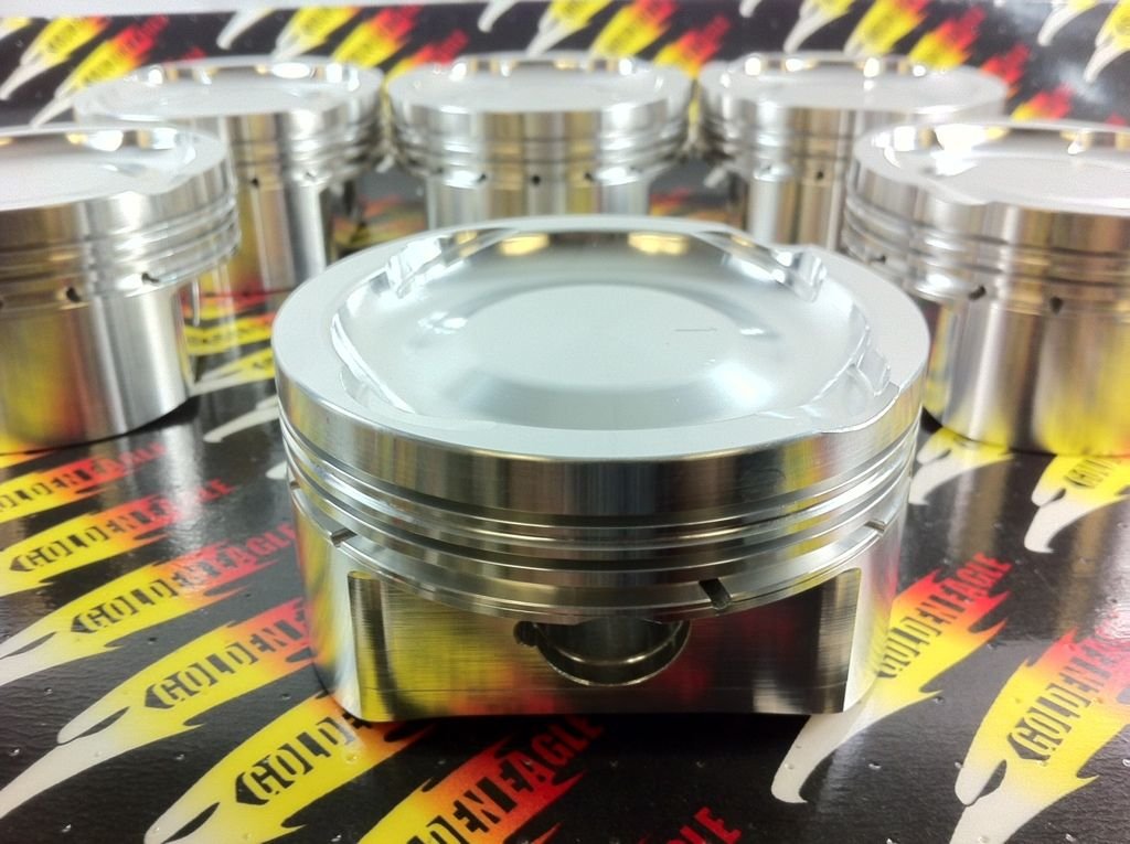

you can send out a stock piston to arias and they will scan it and make a forged one for you with exact valve cut relief and you can gas port them for forced induction cars. I had a set made a while back for my turbo Porsche.
here are some photos of the pistons arias made me and then after coating.
