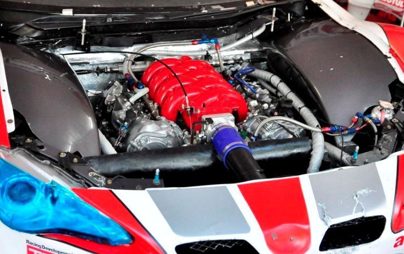

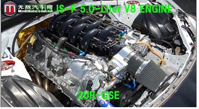

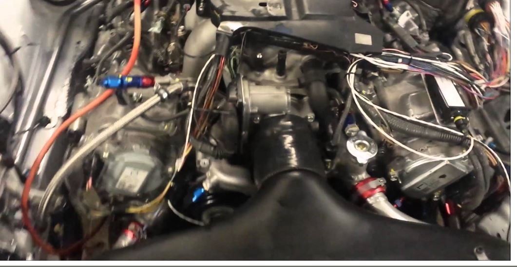

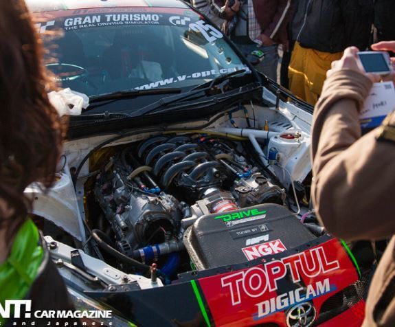

I was looking at couple of race cars with IS-F engines and I noticed that they run a straight short ram intake or some kind of intake scoop. I think an intake like that should have superior airflow than the stock setup and there should not be as much heat soak as stock. As long as the diameter of the straight pipe is the same as the stock pipe where the MAF sensor is located it should not mess with the MAF scaling. I just wondering if the ECU will compensate for the increase in airflow.

I understand that but non of the tested intake get flow like the ones on the pictures; all of the has a similar path to the stock intake with a 90° bend. I imagine those race teams know what they are doing; I don't think they will be adding a component that makes they race car slower.....
