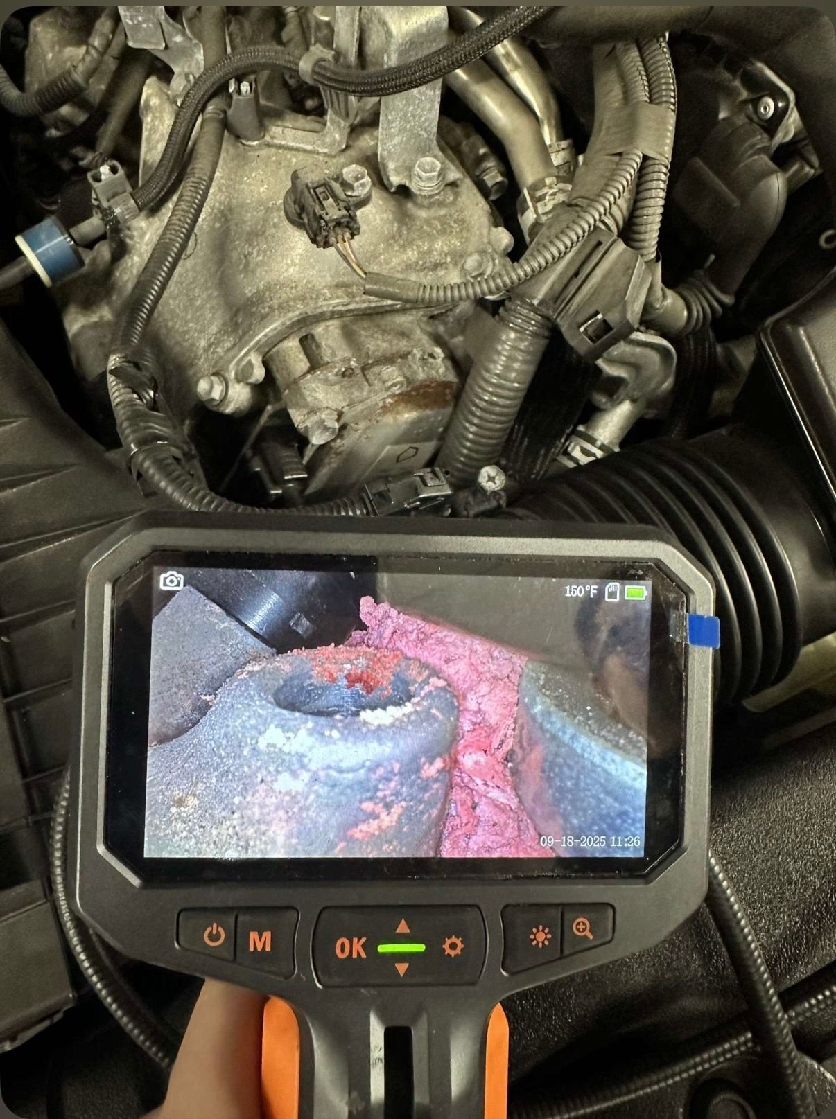

The valley plate is really the only thing to be "concerned" about because it seems they all fail from the factory at one point or another. There's no point in doing this unless it's necessary, and the method for determining this is using a borescope size camera to look under the intake manifold and check for the dastardly pink death. My IS F only had small leaking at 180k (or so, I don't remember the mileage exactly), but my GS F had a lake of dried coolant I had to chip out at only 130k miles.

I’m almost done with this list, also replaced the drive belt tensioner and drive belt. Also a cool finding while my tech had it in the shop 😂
