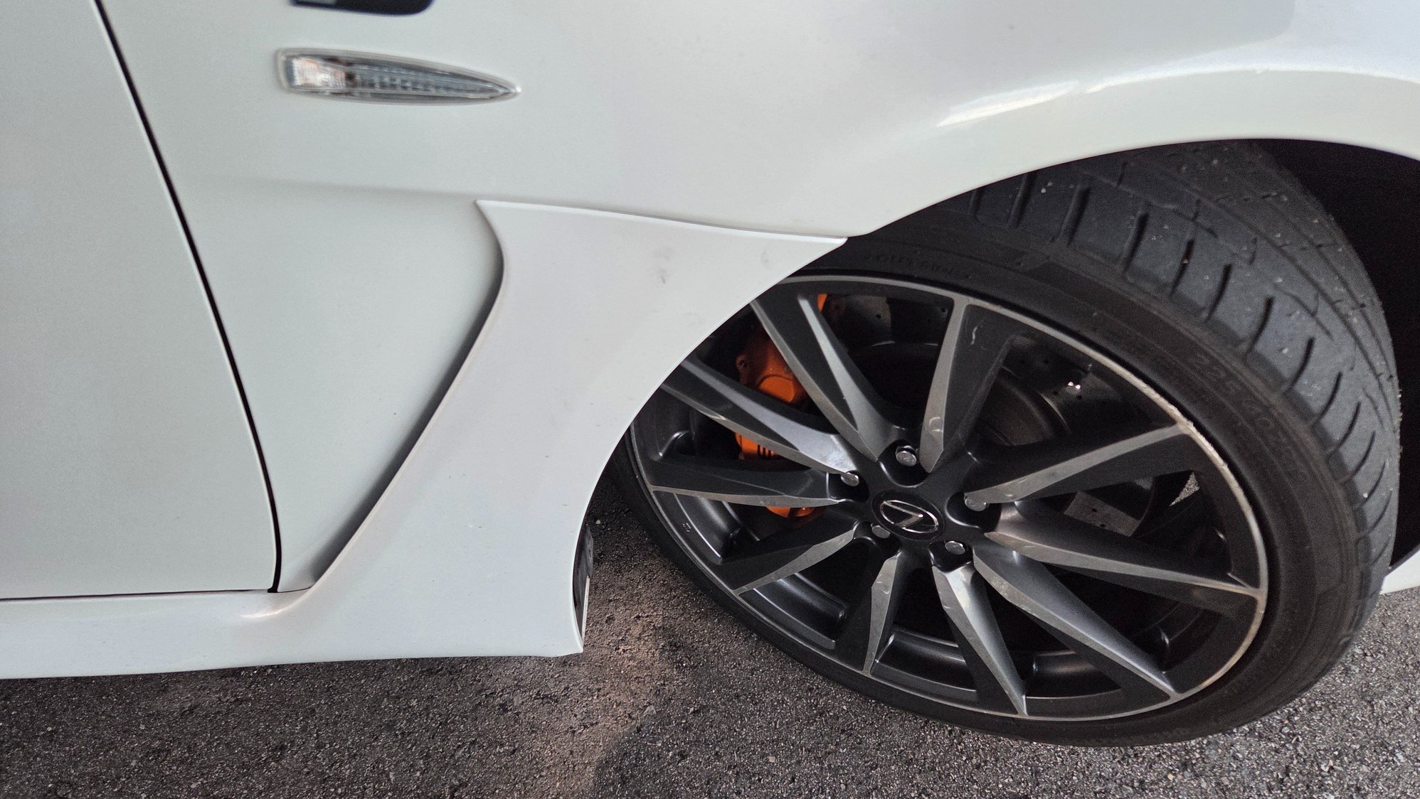

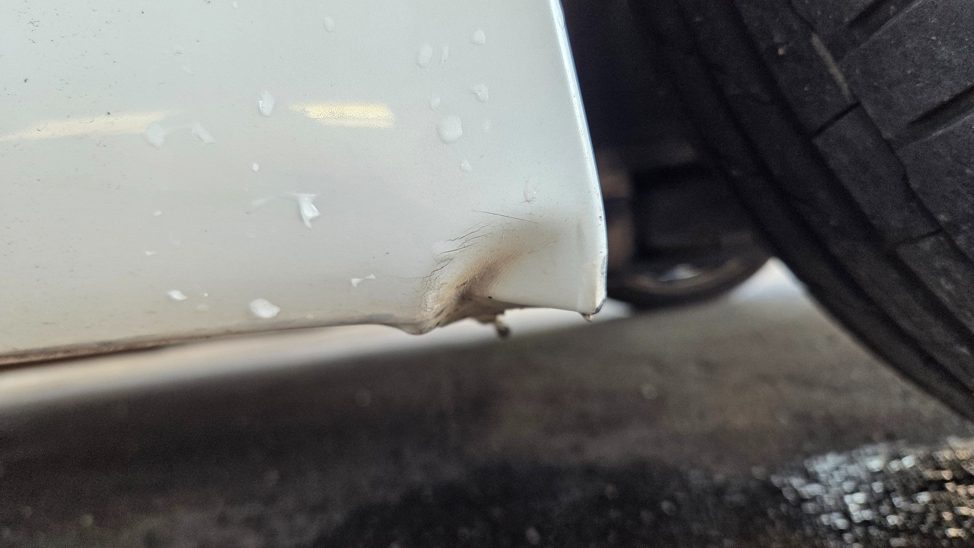

Hello,
The side skirts on my IS F had dents from the time of purchase. I wanted to repair them with a heat gun, but I couldn't push from the back, so I'm trying to remove them. However, the boundary with the front fender (around where the black marks remain in the image) is extremely stiff, and I can't get it off.
I believe I've removed all visible clips and screws. (Honestly, I'm not confident.)
Could you please tell me how to remove it? Google wasn't helpful.
Translated with DeepL.com (free version)

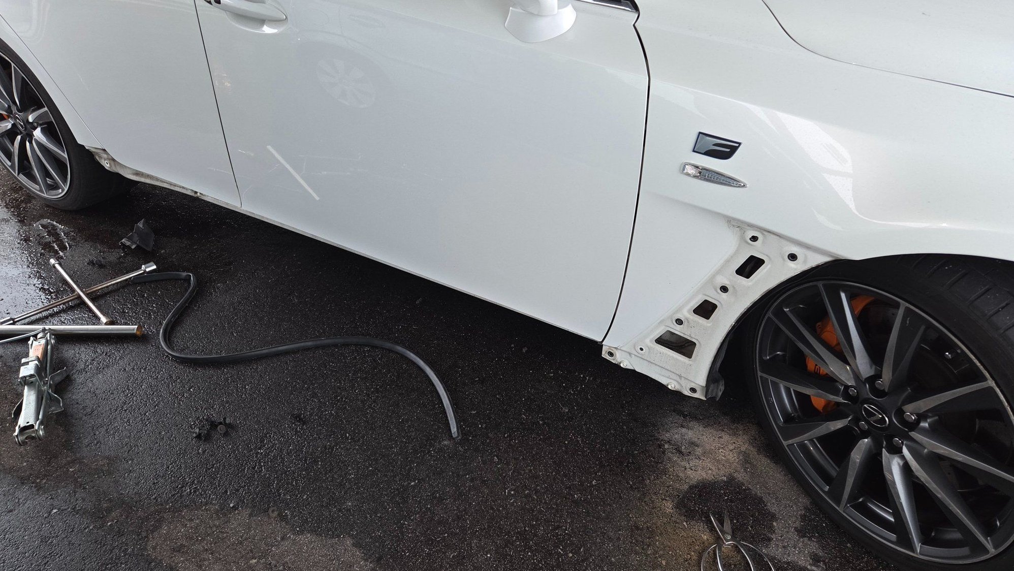

a couple screw behind the weather stripping and it’s just all clips gotta pull
Thank you for letting me know.It seems I forgot to remove the screw inside the weatherstrip.Even so, it was incredibly stiff and made me nervous! Thank you.
