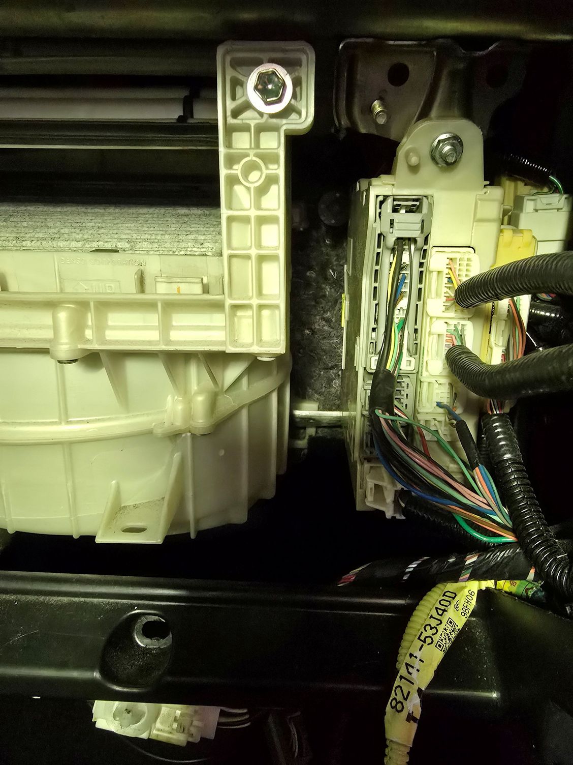

First, surveying the potential relocation site. Between the junction block and the HVAC main housing. Looking pretty promising.
Next a test fit. Yes, this definitely can work, but I'll need to trim the clip off of the side where it contacts the junction block.

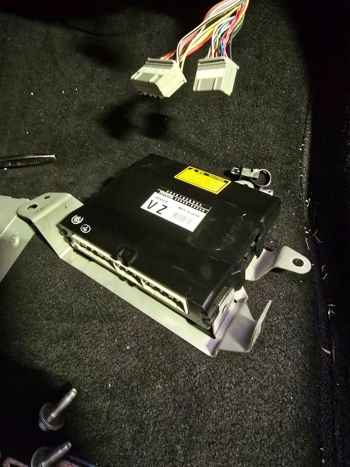

Here's the skid control ECU removed from the factory mount. I plan to reuse the mount after relocating the skid control ECU.
I used a tape similar to JT2MA71's install to hold the skid control ECU against the junction block. I also used a very large zip tie to augment the tape. The zip tie mount in this picture came off the skid control wiring and gets repurposed later in the project.

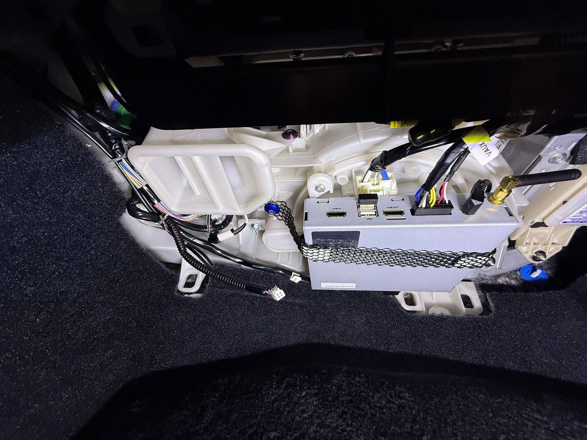

Great job on the install! Although I’ve never had an issue with just the double sided tape, I’ve since added a bracket to secure the unit. I just used some leftover aluminum mesh that I had laying around.

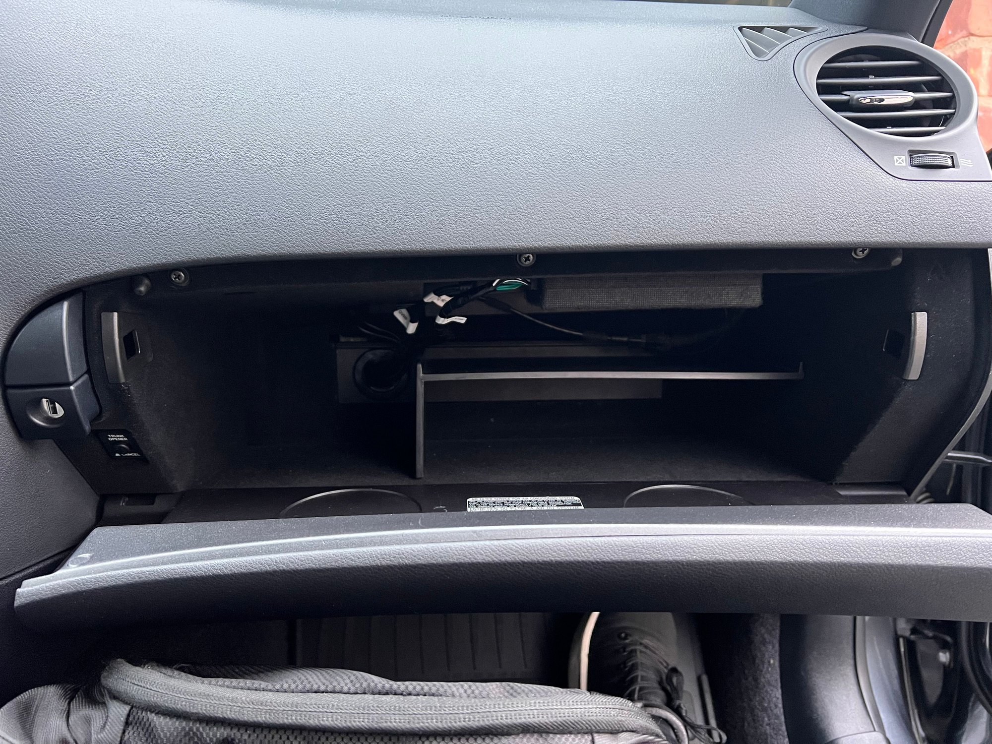

This is the level of car nerd that I love! Thank you - this is too funny and super educational. I've had my unit flicker on a few rough roads and always wondered if my video cable is loose, but it has always come back on. Connection issues are no where near as frequent for me as you describe, so I will keep this in my back pocket for when the time is right. Currently the unit is sitting on a microfiber towel inside my glovebox as I realized I can't keep it secured with 3M velcro to the top of the box.

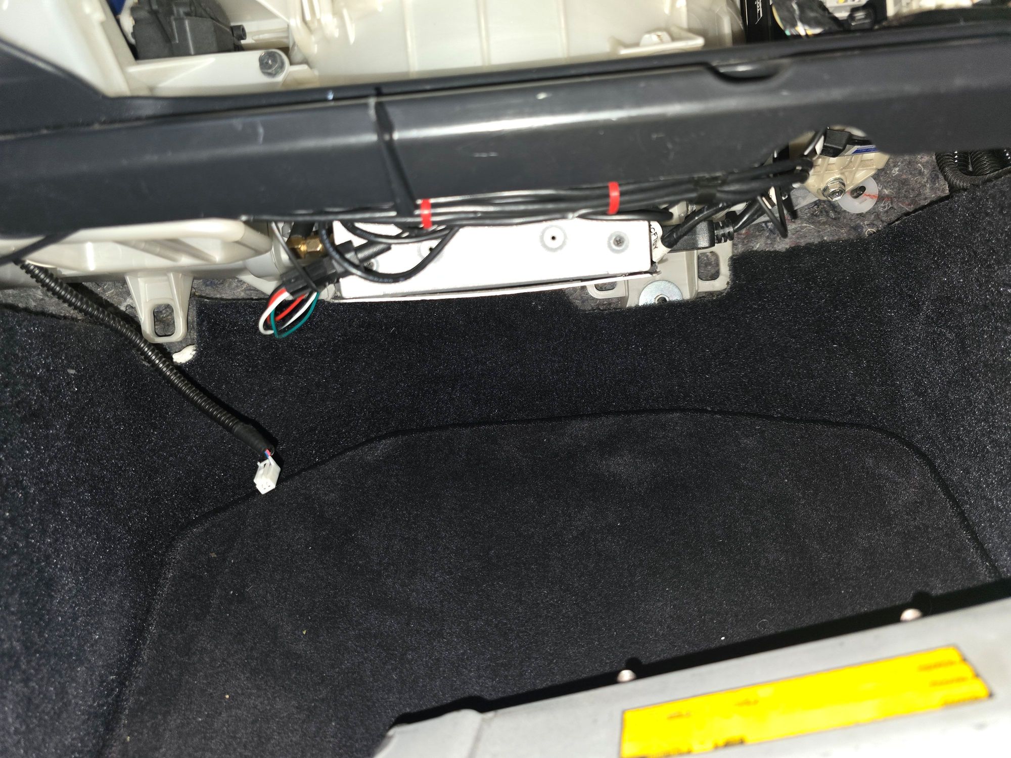

Just the bottom panel. No screws at all. I popped it off today to make sure the antenna was pointed away from the metal and fully tightened. It was easy.
To remove it, you just need to take out the three screws and it drops away into the footwell, only held by the wiring.

No, it works perfectly now. It just didn't like being in the glovebox held by unreliable velcro. Now that it is stable, I have none of the previous issues.
