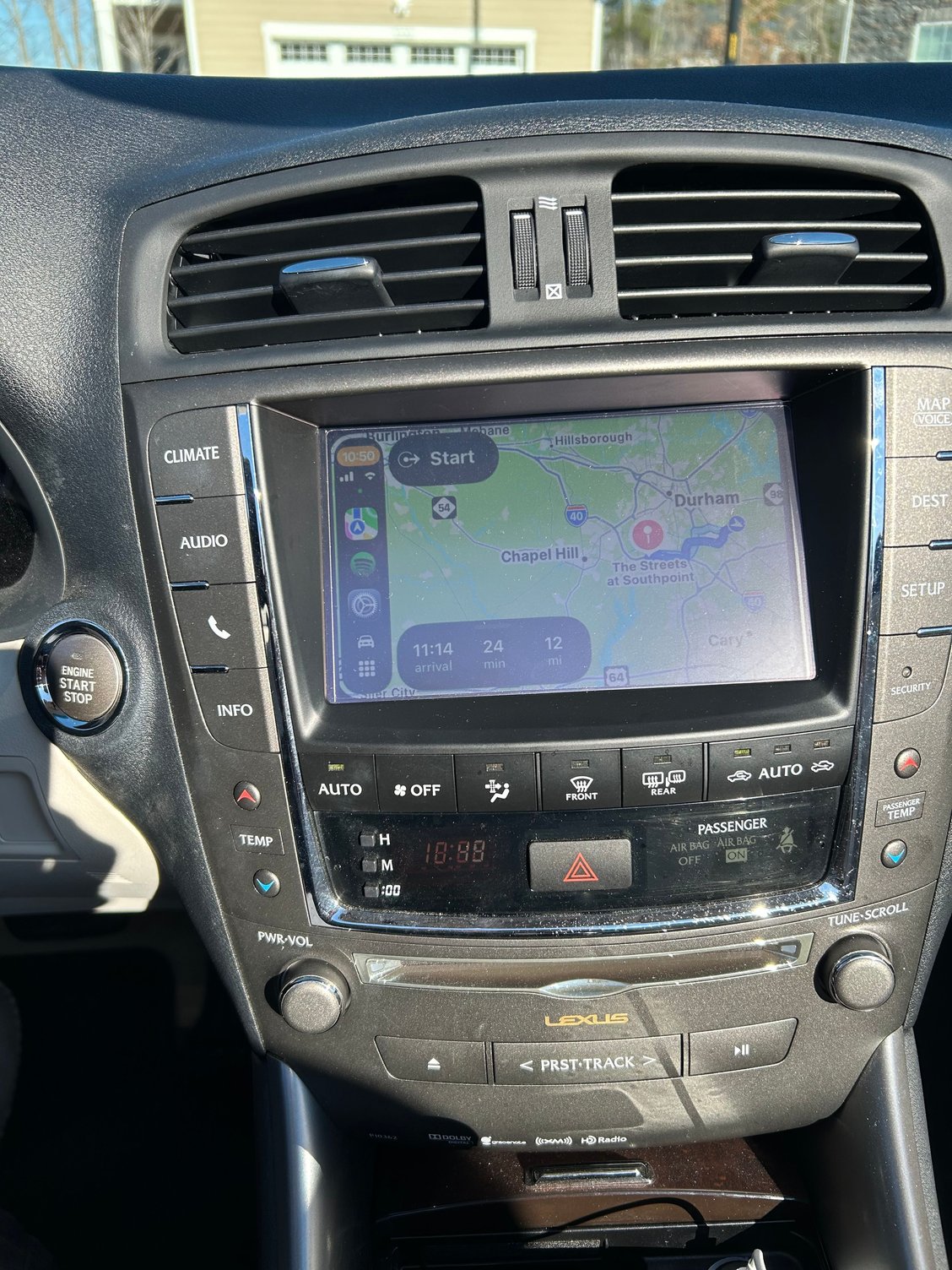

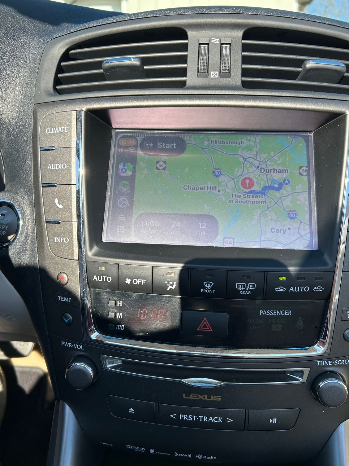

I just wanted to share that I put an anti-glare screen protector from photodon.com on my 2015 IS350C nav screen. While not 100% effective at all sun angles, it did cut the sun glare fairly significantly. I used to have to often hold my hand up to create a shadow when the sun was near my Nav screen. Now I do that far less often. You can see the sun glint in the photos off the head unit trim, but the map is still visible.
This was a custom cut product but only cost $45. I used the MXH coating option and it applies very easily using the kit they send along. The website has measurement and installation instruction videos.

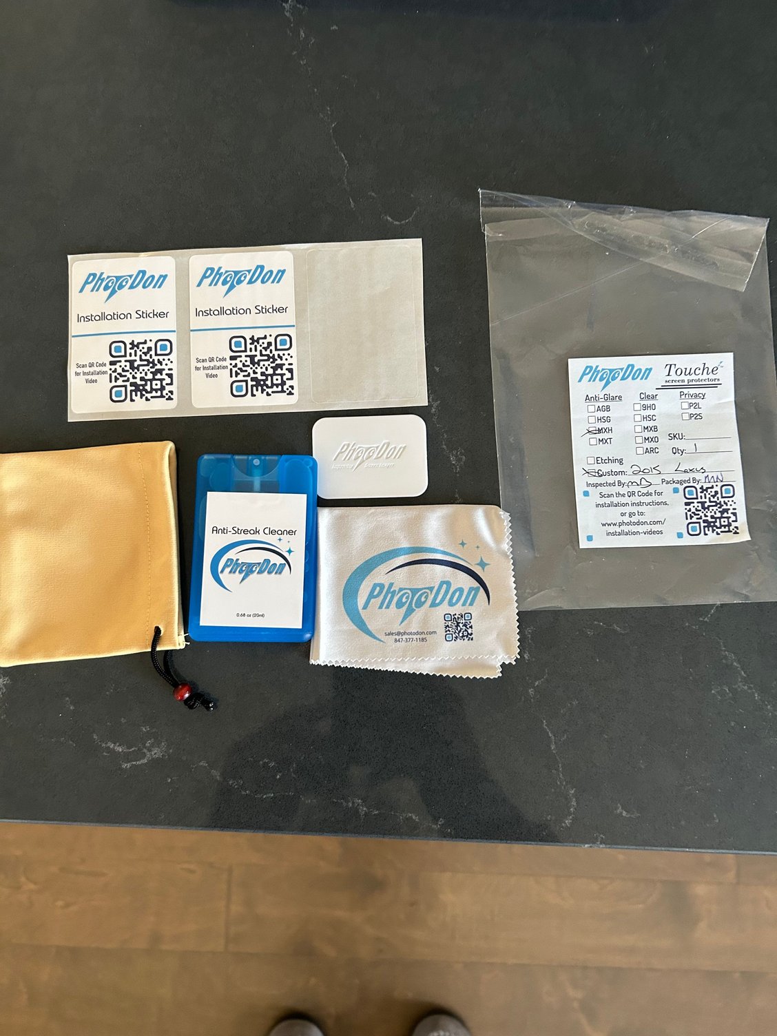

I did 157mm x 92mm. I did not choose the “exact” option in the ordering process. Checking this option results in them not reducing the measurements by 0.5 to 1.0 mm. If I had to do it over again, I would have used 158 mm x 92 mm. It’s just a smidge too narrow by about 1mm.

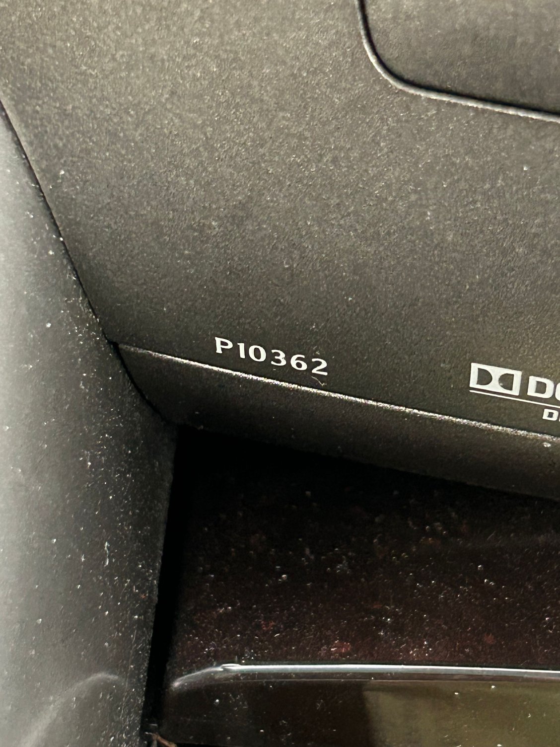

If you order from them, make sure you check the automotive application at checkout to get the components of the kit that I posted a photo of. I’ve also attached a photo of the model number of my head unit in my 2015 IS 350 C and the details of my order
