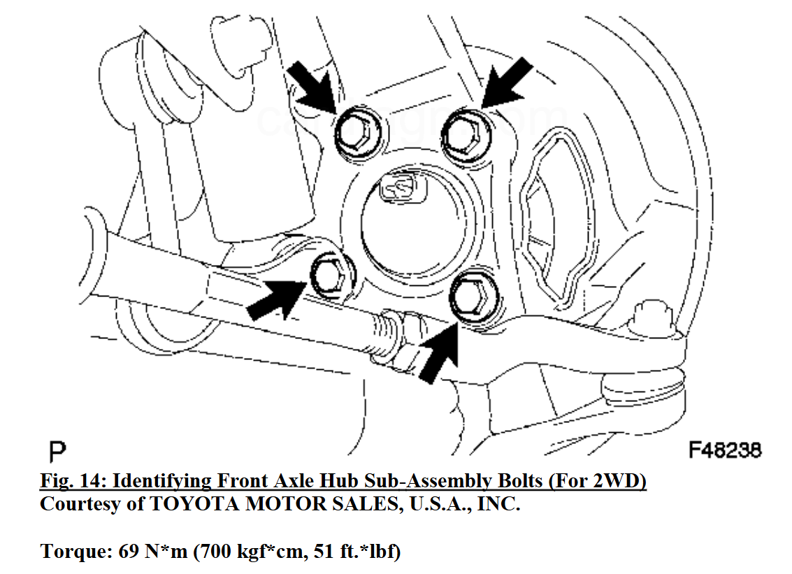

Hey, I am currently installing ISF calipers on my IS500, but accidentally loosened a knuckle bolt and can’t find the torque specs.
its the one just beside the caliper bolt.

I can only find this for a 2007-2011 GS350 but it looks similar

Thank you, i torqued it to 58 as a precaution before your post. I imagine it will be fine.
