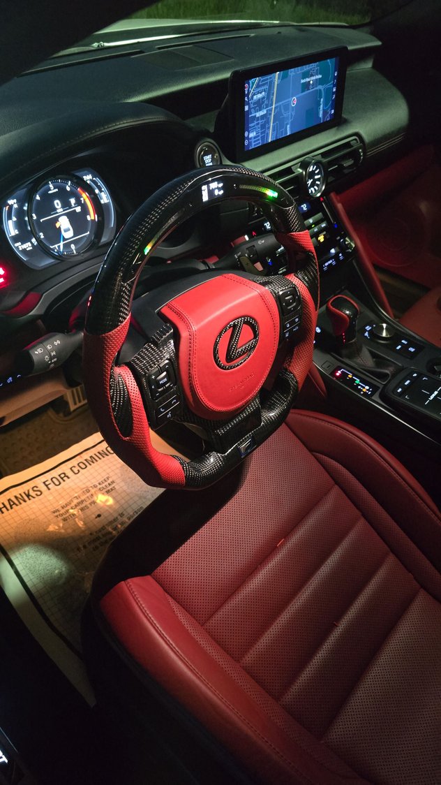

Originally Posted by ggermoson
Did any of you @chi3fy @drizzo77 manage to install the steering wheel. i have an is350 2023 and i want to install a led carbon fiber steering wheel but before i do it wanna see if you can give me some pointers.
yes i did install the wheel but havent had time to wire it in started raining and getting dark. i will get around to getting it done soon. everything works as expected tho. Preview attachment 20240825_183303.jpg
