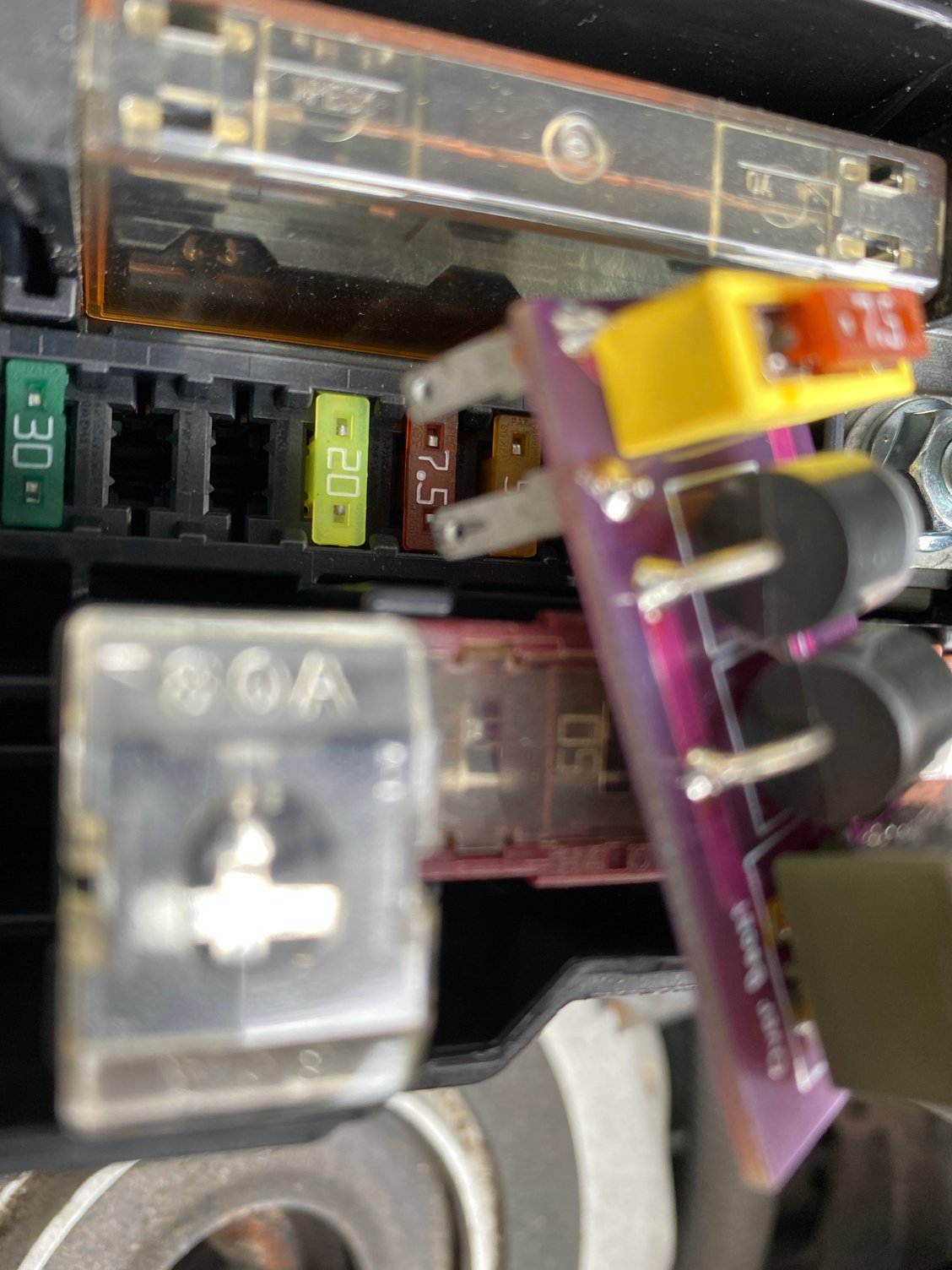

You can't control the voltage like the Arclight voltage booster but its the cheapest way to verify proof of concept. There is also no guarantee the Arclight booster will fit under the fuse box cover (the switch extends up and might interfere with the cover).

Just wanted to follow up on this thread. I picked up the ArcLight Voltage Booster for my 4Runner (when I eventually get an AGM battery for it) and figured I'd see if it fit in the 3IS. I also have an AGM in the ISF but I haven't taken it out of winter storage yet (will test that also).
Unfortunately, the ArcLight booster does not fit in the 3IS. The circuit board is oriented perpendicular to the fuse box, and as such, it does not reach the Alt-S fuse. Looks like the only solution for the 3IS is to get one of the GM fuses.
