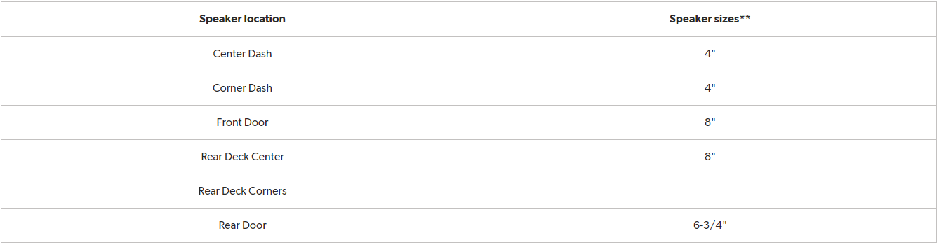

Aren’t some of the speakers hard to upgrade because they are not a standard size?

Speaking from experience with upgrading the non ML audio system/speakers in my car (the 2021 has the same speaker setup, at least it does for the non ML), most of the speakers are a standard size with the exception of the front door speaker which is a 8" mid-range woofer, but audio shops can make/install or sell you a conversion adapter plate that goes in that hole to convert it to hold a 6.5 if you want, which is a good option for the front door. The rear deck 8" I would either keep the OEM one and connect it to the aftermarket amp, or replace it with another 8" low range subwoofer, but the mounting depth may limit your options. You can find aftermarket 8's but they are an uncommon size (as far as mid range for front doors, so you don't have a lot of options. 8" low range subs are easy to come by so the rear deck would be easy to upgrade).
The front dash speakers are 4" for highs, those are easy to find. The rear doors have 6 & 3/4 but will fit 6.5's just fine, which are also a common size with tons of options.
Connecting to the OEM amp isn't really an easy option, so you would be looking to do a full amp + speaker setup, likely with the help of a car audio shop.
Our headunit cannot be replaced as it's intergraded with other systems in our car, but they sell a harnesses that ties into the OEM stereo to provide the RCA output for an amp.
As mentioned by others in this thread, upgrading a non ML system to a ML system would be a massive hassle, crazy expensive, and just not worth it. If you are set on upgrading your stereo system, a full aftermarket amp + speakers + DAC/ audio control line out converter unit (for adjusting/tuning and balancing the sound stage) is the way to do it.

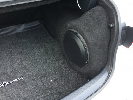

As to this comment, I agree that a big speaker box in the truck is not an elegant solution, and and bigger sub is not really needed, depending on what type of music you listen to and your preferred amount of low range sound, but there are options for a a sub without a big box if you desire it, keeping your trunk space, like this:
Or as mentioned by me above, you can just upgrade the rear deck speaker to a moderate level 8" sub, or just keep the OEM one and power it with the new amp, which will make it sound better.

Thanks. Does anyone have the speakers’ specs like frequency range, sensitivity? That would help decide the upgrade path. If I can get away with just upgrading the speakers, I’ll take it. However, I certainly don’t want to go down that path if it ultimately will still mean adding an amp or a self powered sub.
