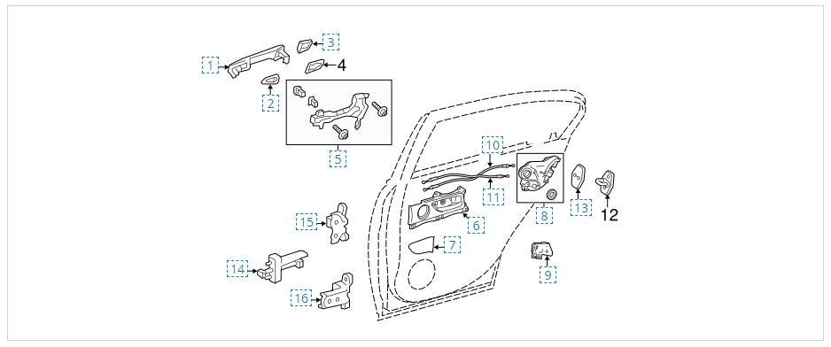

A little more info may be needed to help you find the part number.
Here is a pic of the rear door and the 16 parts that make it up...other than the actual door itself (https://www.discountpartsmonster.com...cal--rear-door).
Assuming that part is attached to one of the sixteen parts, maybe you can indicate which side door this broken piece belongs to and what part it came off...as it appears it is not sold seperately.
At a guess I would say it's either part of number 5 or 6.
