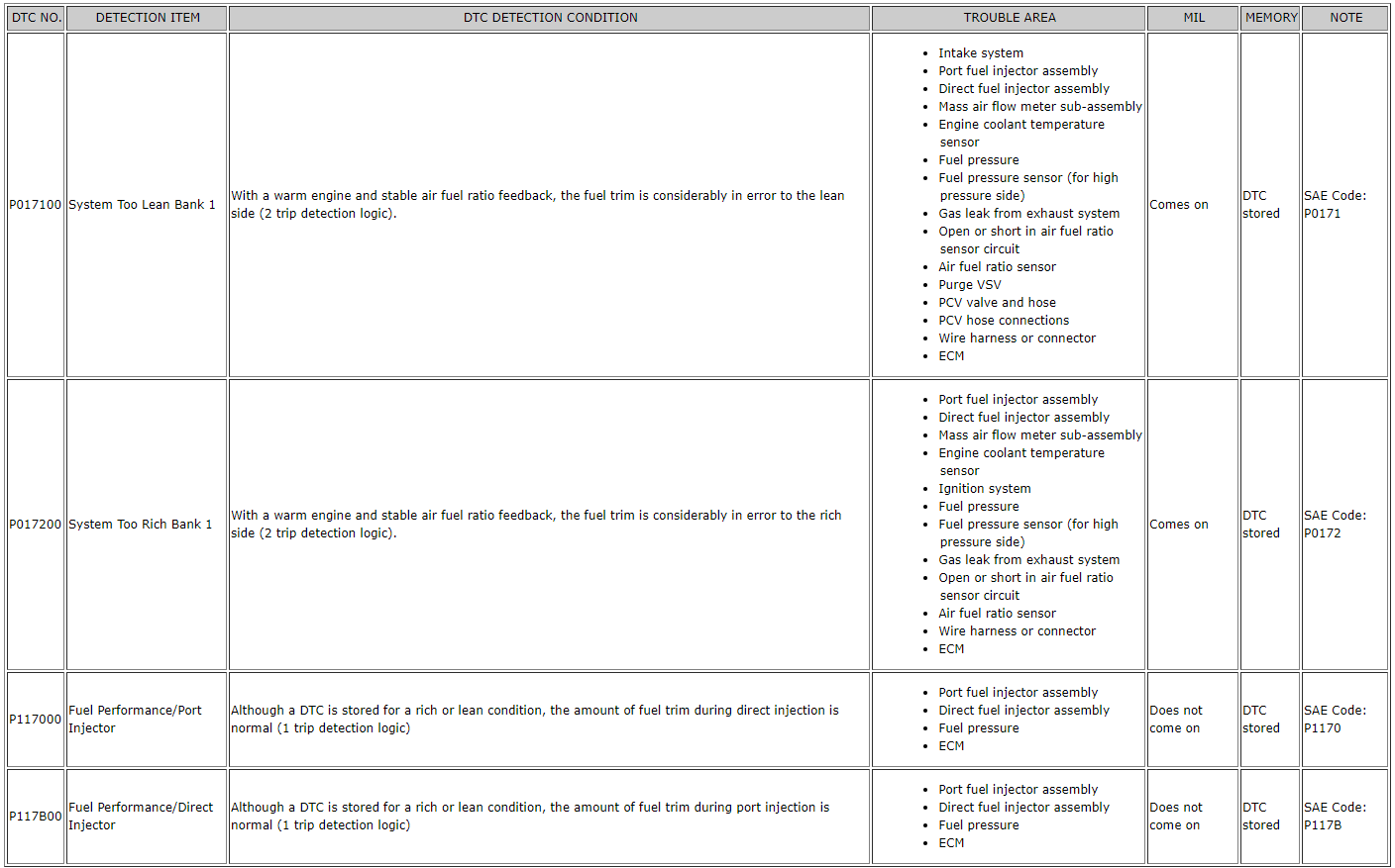

Here's a breakdown of the codes:
I would definitely check to see where that oil is coming from.

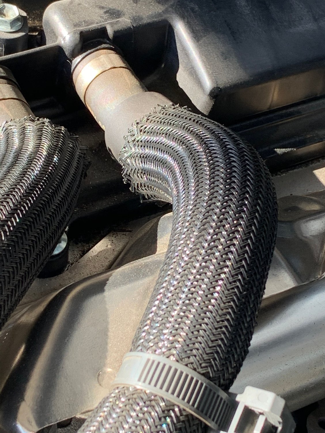

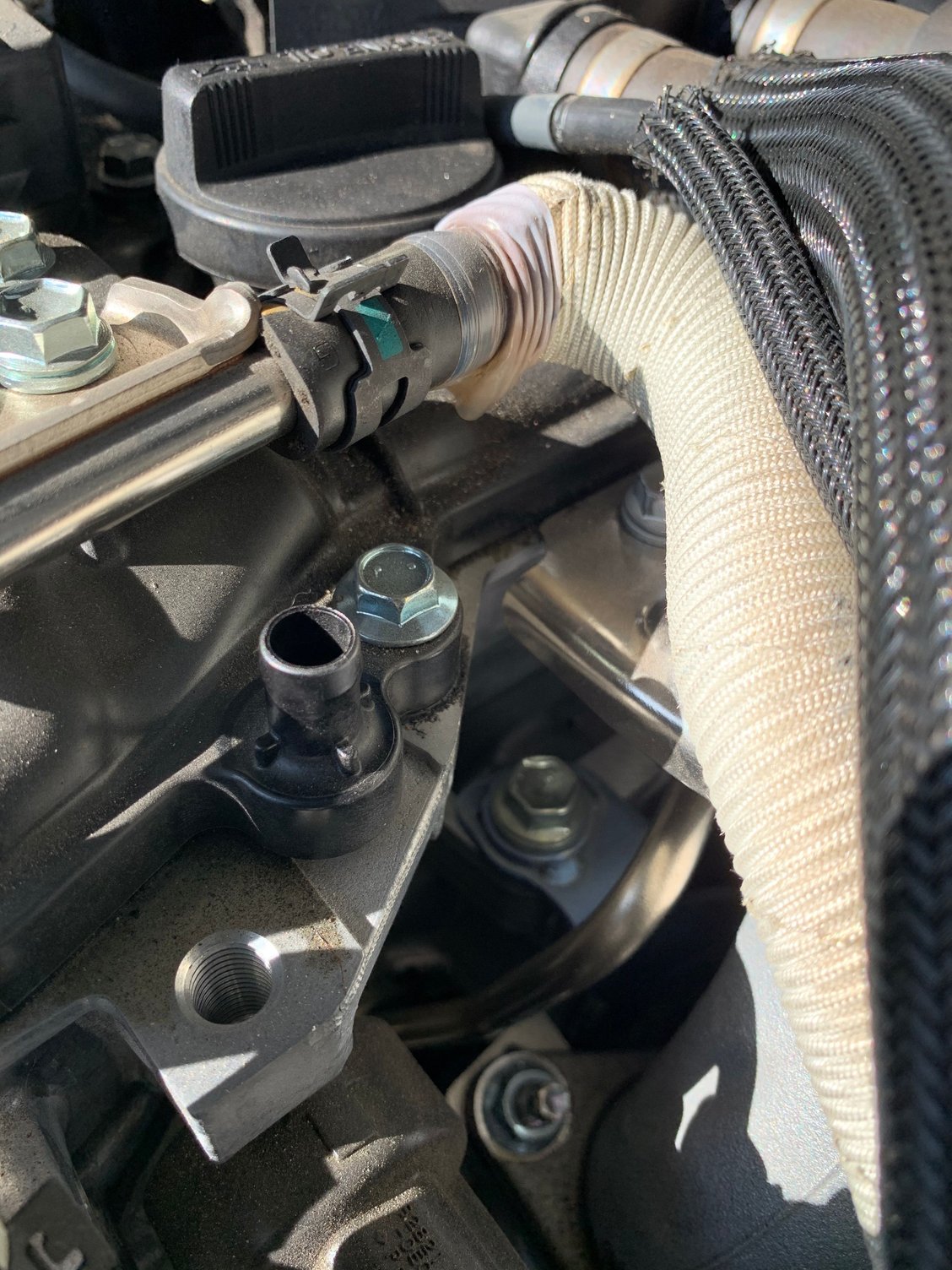

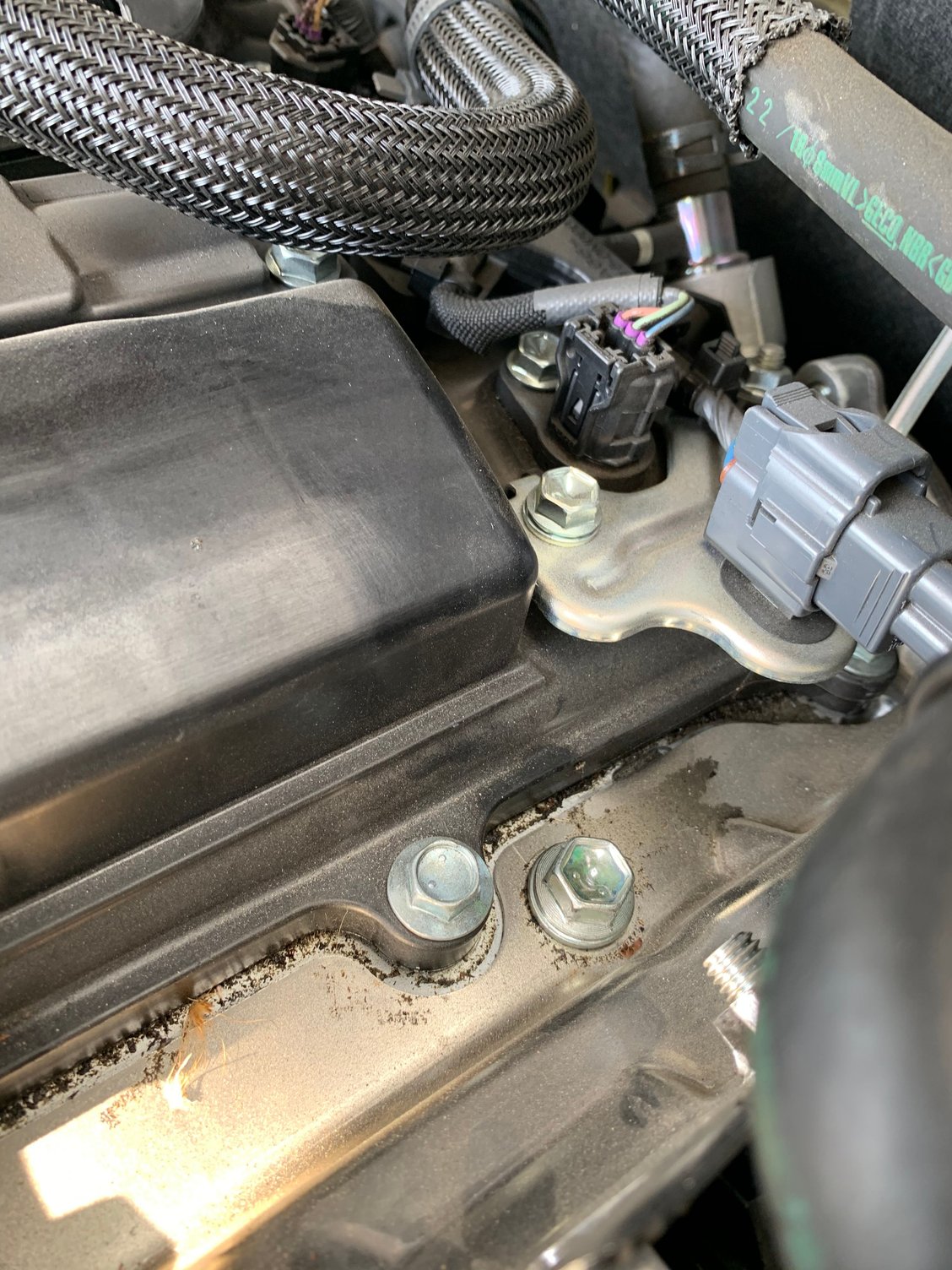

So I just checked again and the hoses are all plugged in and are not loose. I did replace the regulator about 4k miles ago (third time). It seems like the oil is coming from underneath the valve cover but I can’t tell exactly because theres also oil on the turbo muffler. Do you think it could be the valve cover gasket? I took some pics but its sorta difficult to tell in pictures

Any chance that was just oil that was spilled when filling the engine after an oil change?
Just based on the pics i would consider that sweating more than a leak...but i realize it may appear as more in person.

hard to tell but I don’t think so because I got the CEL and the drivability issues before I got an oil change. When I first noticed the oil after getting the CEL there was considerably more and it was still wet. I got an oil change after that and they cleared the CEL and added fuel injector cleaner. Its been a while now and the CEL hasn’t come back and the oil has definitely dried compared to before. The car still feels sluggish and it loses power briefly in the upper RPM range with some backfires if I’m going WOT

Are you able to flash it back to stock to eliminate the tune being the issue?
Your description above really sounds like a boost regulator...even though you just replaced it. I know that sounds unlikely.
Also that second code is basically telling you that even though you have a lean condition, the direct injectors are supplying a normal amount of fuel.
Where in reality if the car was running lean, the direct injectors should be supplying the max amount of fuel...in an attempt to correct the lean condition, before the code finally triggers the CEL.
